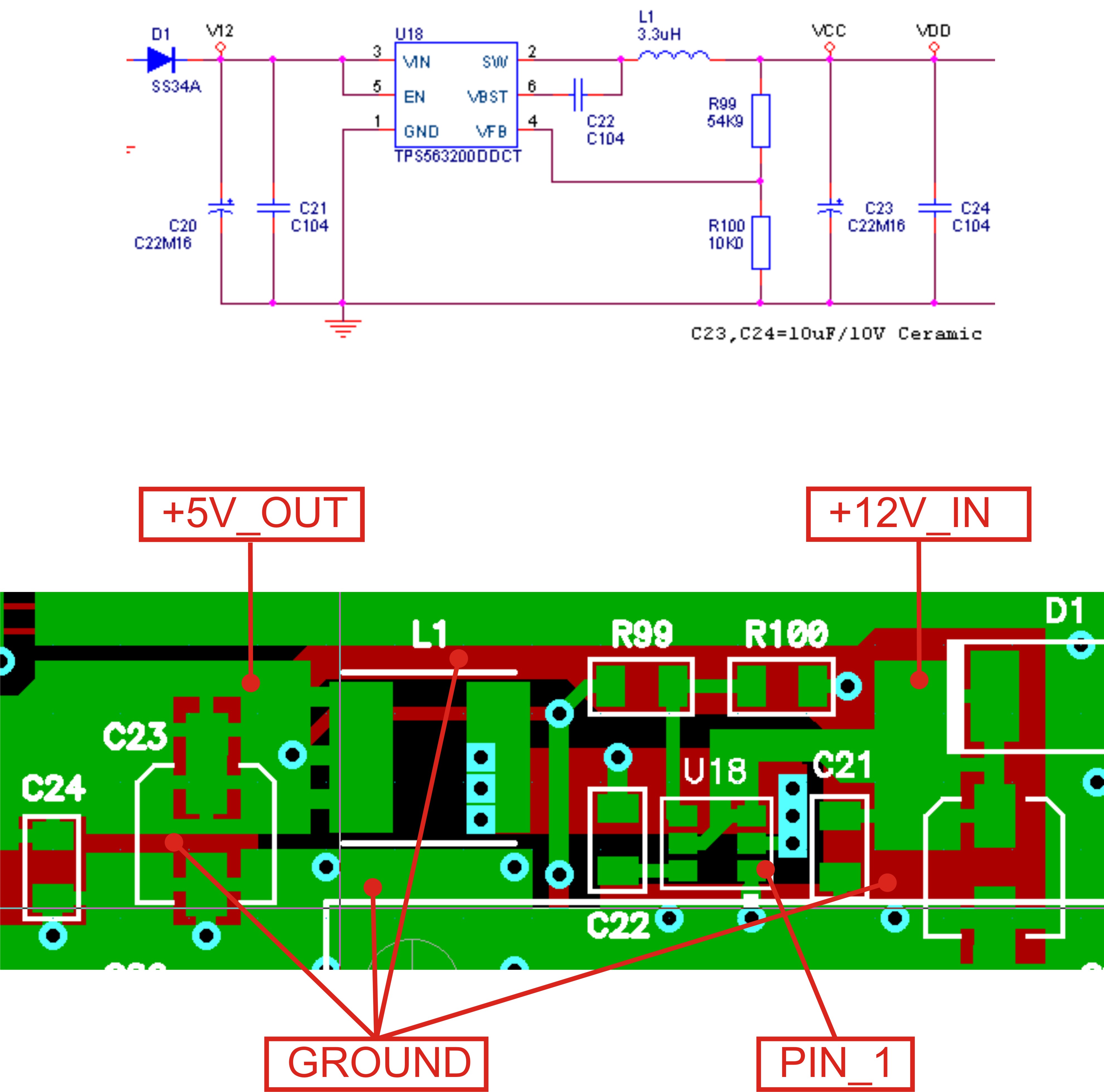

We are using a TPS563200DDCT to get 5V-1.5A from 12V input to supply our board with several MCU's, etc.
Surprisingly, anytime i make a short in the output, the low side mosfet gets shorted.
I did it several times using new parts and the result was always the same. In normal circumstancies all goes ok.

    Could you please share the schematic and layout? Let's review them. If the VIN is high and layout is not good, the low side FET would be damage because of the large spike of SW during output short test.

  • Hi, thank you by your quick answer.
    VIN is 12V so is far from the max limit of 17V.
    About the spike on low side FET, i agree, when the high side FET turns off, the current on the low side FET is maximum and decreases lineary to zero(discontinuous mode).
    By the way,
    Component notes:
    - R99 = 54.9K, VOUT=5.1V.
    - C23, C24 = 10uF 10V ceramic multilayer. Inclreasing this values i get less ripple as expected.
    - C104 references = 100n /50V ceremic multilayer
    thx,
    Lino

    It seems the feedback resistor is far away from the GND of IC, and the trace is long. Could you please share the waveforms? And what is the part number of output capacitor?

    1. Output ripple has nothing to do with traces but the wrong type of capacitor mounted. After mounting the appropriate one the output ripple falls to 40mV p/p - SOLVED
    2. For Iout = 2A, the chip temperature rises 25 degrees above the ambient. I do not like this, so, a heat sink welded in the ground plane, the temperature is now just 10 degrees above the ambient - SOLVED
    3. Low side FET blowup when output is shorted: The only way to avoid this issue is mounting a schottky diode in paralell with low side FET. - SOLVED
    4. In addition to the one mentioned above, everything else is the same as mentioned in the data sheet.
    Conclusion: points 2 and 3 are critical what leads me to think that this silicon version needs some attention from Texas.
