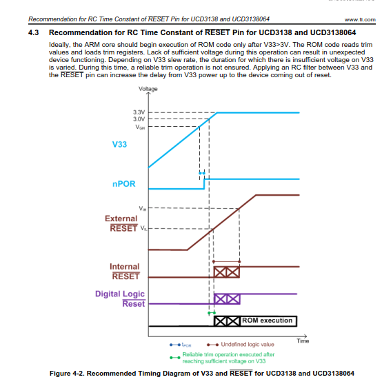

About Practical Design Guideline ( slua779a ) Page.22 -> 4.3 Recommendation for RC Time Constant of RESET Pin for UCD3138 and UCD3138064
Among them Figure 4-2 , What's the Reliable Trim? and what does the mean Recommended Timing?
