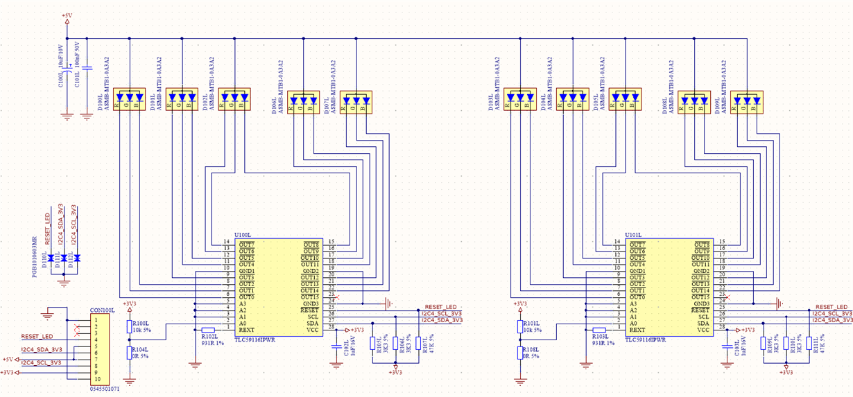

Hello, I´m Federico Linares Hardware Engineer from ControlNet and I´m developing a new product with TLC59116IPWR Led Driver. This IC works good in normal condicions, but fails in the
IEC 61000-4-2 electromagnetic compatibility Test (the IC Reset and the registers returns to original state).
Could you recommend us some configuration to improve the stability of power and reset line?.
