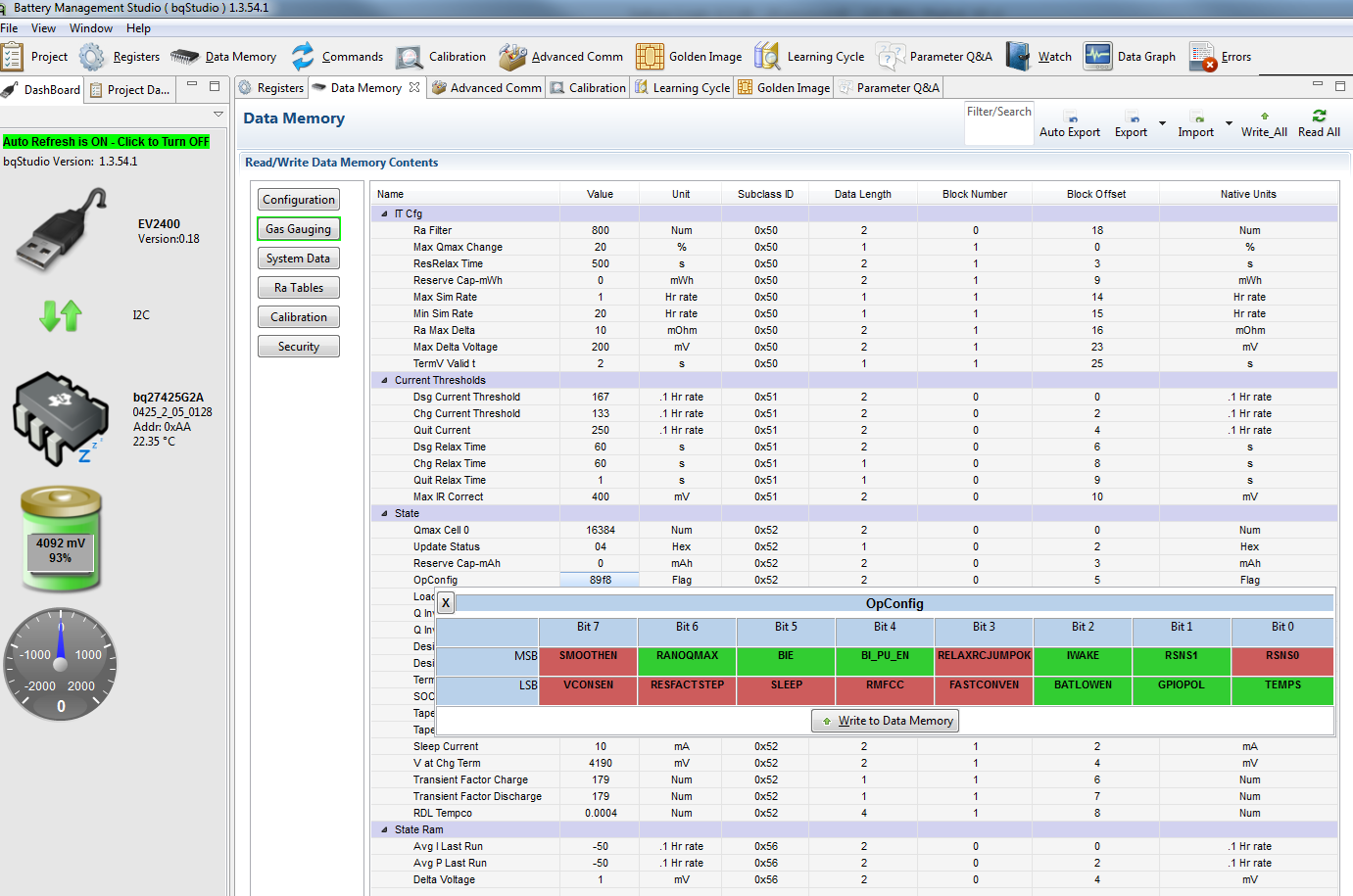

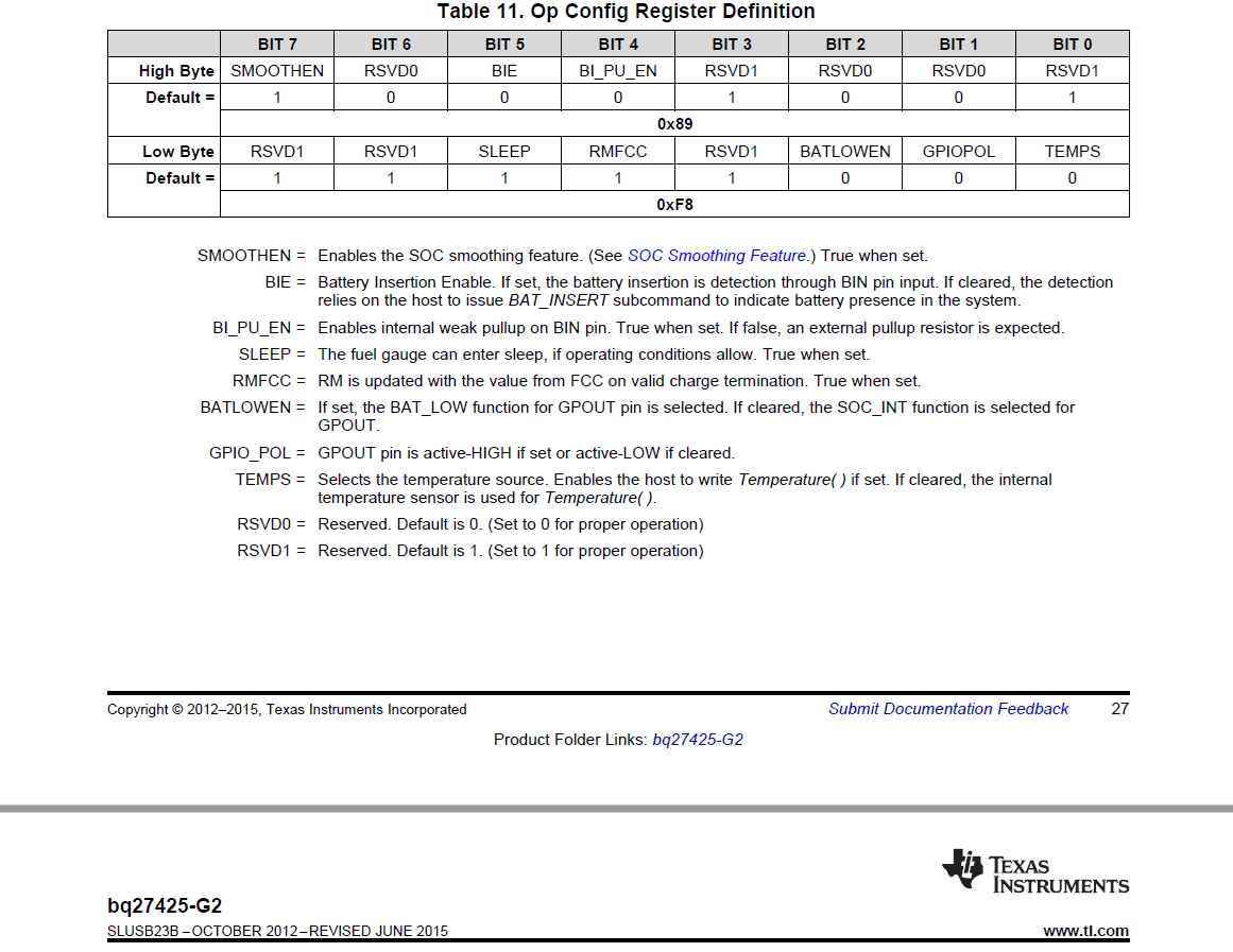

I am working with “bq27425-G2 System-Side Impedance Track Fuel Gauge With Integrated Sense Resistor datasheet (Rev. B)”. It is seems that it is not aligned with the Battery Management Studio ( bqStudio )
Version : 1.3.54.1 .
Attached below Operation Config. Register description from both sources.
According to what reference should I refer?
Is there an updated datasheet available?
