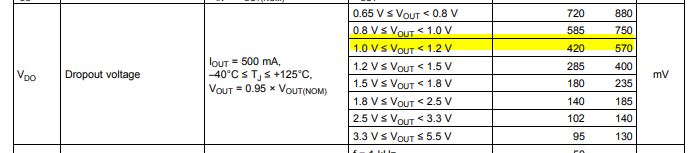

Are there the Vdo data of TLV757 and TLV758 when Vout=1V and Iout=0.3A?
Yokota
  • Hi Yokota,
    Dropout for linear regulators has a linear relationship with Iout.  As such we can calculate the dropout using a simple ratio and the data provided in the Electrical Characteristics table.  Below I will demonstrate with TLV758P
    For a 1 V output at 500 mA we see that the maximum dropout is 570 mV.
    Vdo_300 mA / 300 mA = Vdo_500 mA / 500 mA
    Vdo_300 mA / 300 mA =570 mV / 500 mA
    Vdo_300 mA / 300 mA = 1.14 mV / mA
    Vdo_300 mA = 1.14 mV / mA  x 300 mA
    Vdo_300 mA = 342 mV
    Our calculated maximum dropout for a 1 V output for TLV758P at 300 mA is 342 mV.
