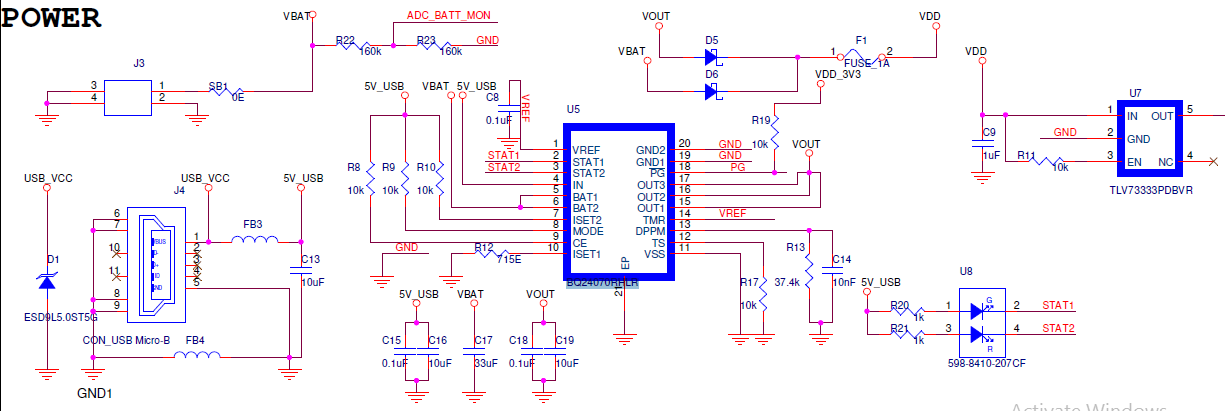

Hi
I am currently working on BQ24070RHLR single cell lithium ion charging IC in our application.
I am facing some problem. They are listed below.
1. Charge current won't exceed 450mA.
2. No indication of charge cutoff in IC.
3. Even battery is not connected still IC shows charging indication.
I am attached a screenshot of our circuit we are currently working on. Please review and suggest some changes if needed.
In brief we need charge current of 1.5A and we are using 5V 2-A AC adapter. We designed circuit for getting same output response.
