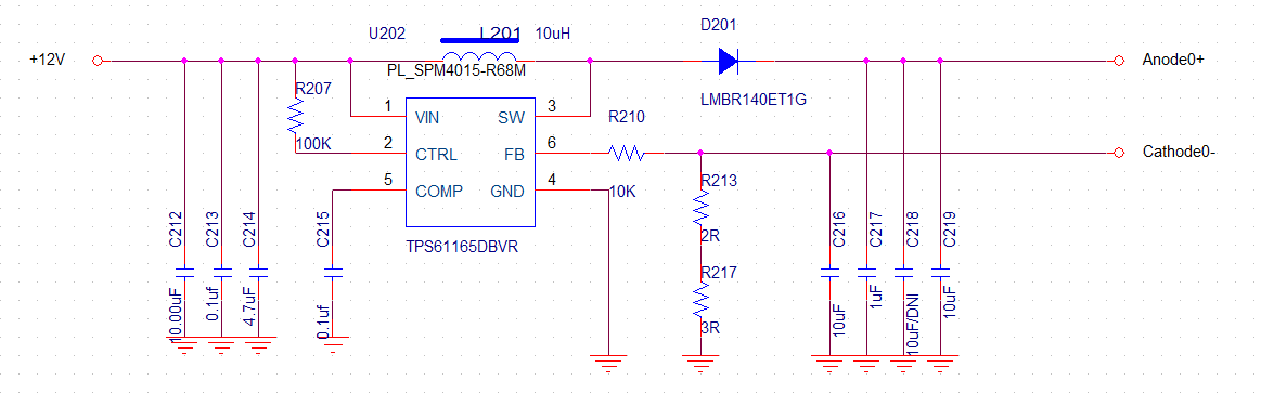

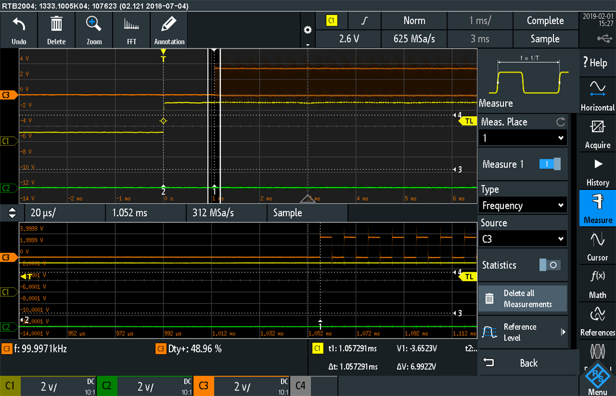

TPS61165: I can't enter in PWM mode
Part Number: TPS61165
I would like to use TPS61165 in PWM mode, not in EasyScale.
I join picture of oscilloscope with :
  • CTRL : C3 orange line
  • VIN : C1 yellow line
  • FB : C2 green line
Lower window is a zoom around the beginning of PWM.
With this signals, TPS61165 is in ES mode. When I read datasheet, I understand that I should be in PWM mode. Could someone explain to me why I am in ES mode ?
