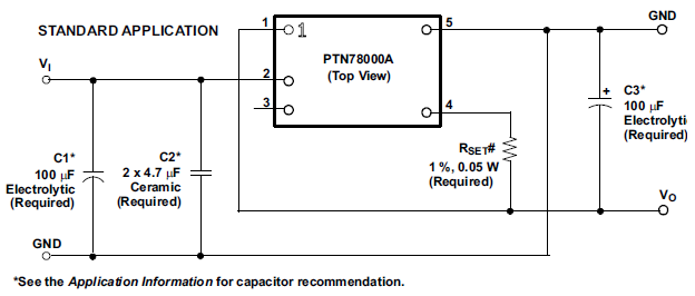

The PTN78000A datasheet says on page 10 that "100uF of nonceramic capacitance is required on the input bus."
Is there any reason all the input capacitance cannot be ceramic?
Ceramics have become amazingly small.  I can get 100uF at 16V in a 1210 package.  Disadvantage are capacitance decay over time, capacitance decreasing with DC voltage, and piezoelectric noise.  Electrolytics certainly have their disadvantages: packages not smaller than ceramics, shorter lifetime, need to specify low ESR and calculate heating due to ripple current and factor that into component life.

  • Hello Charles,
    These modules are probably 15 years old and at the time there were probably no high value ceramic capacitors with the proper rating. The ceramic capacitors should work OK, just be sure to consider the capacitance de-rating under voltage bias.
    Question: Have you considered newer modules like the LMZ34002?
    Here is the datasheet for that part: www.ti.com/.../lmz34002.pdf
