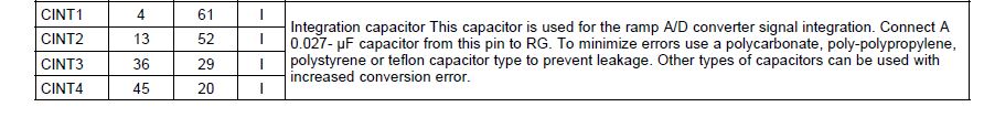

Hi Team,
My customers have pulled up the CINT pin to 6.3 V at 12 MΩ.
I don't know the reason.
CINT 1 to 4 are similar processes.
I think that this pull-up is unnecessary in my opinion.
Is there anything else you can think of by attaching this pull - up resistor?
