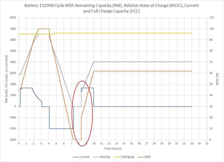

On one of our product lines, we are experiencing occasional fallout for inaccurate RSOC when the battery has been cycled. We cycle the battery through a full charge/discharge cycle, then charge it to 30% state of charge based on added capacity. In one of the failure modes for RSOC failure, when 30% of battery capacity is added, the battery comes back reporting RSOC at 60%.
When the battery was cycled with SMBUS being captured, it was found that when the battery is charging from RM = 0mAh, RM jumps to 1300mAh as soon as charge current is supplied. The protection PCBA is based on the reference design for this gas gauge. Can you provide any insight on why this might be occurring on the particular battery? I have attached the SMBUS log along with flash readings for every five minutest that the battery was runnining and a senc file pulled when the cycle test was completed.

  • Hi Jeffrey,
    I'm unfortunately unable to load your dfi file. However, on analysis of your Ra values, it looks like there is a weak connection or weak solder in the pack. The evidence is in the Ra table, the values are supposed to be monotonic from Ra0 to Ra14. However in your failed pack I see Ra3 to be much higher than the values up to Ra6 or even Ra7. This either indicates a bad connection or a manufacturing defect.
    Ra4 is basically what can possibly be the characteristic resistance of the battery. Given that high a value, given your selection of load select, on charging looking at the OCV, it appears that for your chem ID the battery finds itself estimating a 20% capacity. This is why it reads 20% on start of charge when the gauge does remcap simulations.
  • Batt,
    Before I destroyed the battery to inspect welds, solder joints, etc., I reprogrammed the battery with the dfi and recalibrated. I then cycled the battery several times without SMBUS, and found that it was meeting the expected RSOC/RM every time. I then cycled it monitoring SMBUS/Flash. As you can see from the attached chart, the jump from 0% to 20% immediately upon charge current being applied is no longer occurring.
    I still intend to open the battery to inspect the workmanship, but would appreciate if you could continue on the path of investigation regarding the programming in parallel. I have uploaded a zip file that contains the SMBUS log, the flash logs after reprogramming the battery with the dfi file, and the golden dfi, rom and gg files (EMP00191) . While I don't think there is anything wrong with the gas gauge itself, I still suspect there was an error introduced in the program while being loaded from the golden file by our supplier's automated system.

  • Hi Jeffrey,
    On looking at both your logs, we do see a significant difference in the resistance tables that the files with the jump and without the jump. We believe that this calculation resulted in bad RSOC estimation. The reason for the difference was that your senc file with the RM jump had corrupt OCV tables which resulted in bad OCV readings. So, you are right. It was some issue with programming in the production line.
