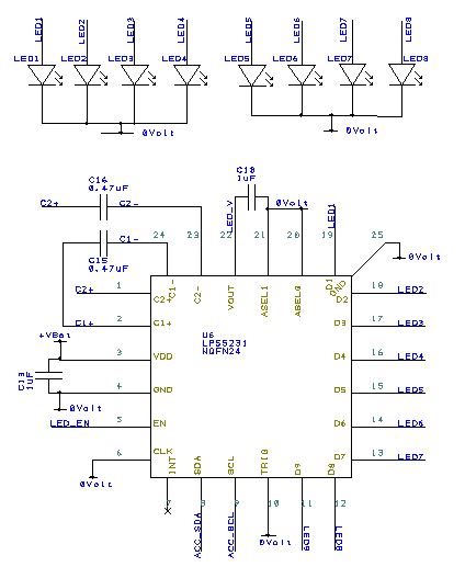

I've put the LP55231 onto my PCB design, and am having issues with getting it working. I2C interface is up and running, and I can successfully force into CP mode and not (with VOUT ADC check working accordingly). However, none of the LEDs are working...! To try and debug I have taken LED2 off of the PCB, but running the LED ADC test I get the same reading for both LED1 and LED2 (0x2a). I've set up registers as follows prior to this test (you'll see LED1 and LED2 differ from others - purely done as part of this debug:

I'm running through in debug mode and as I say, get expected value for VOUT ADC testing, but 0x2A for both LED1 and LED (even with LED2 not populated). Schematic as follows, and I'm confident the layout matches (although confidence waning somewhat at this point!!). Any idea what might be causing this issue?? This was meant to be so easy...! I've repeated same issue on a number of PCBs, so don't believe it is chip-related.

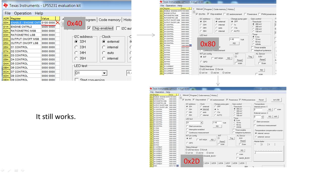

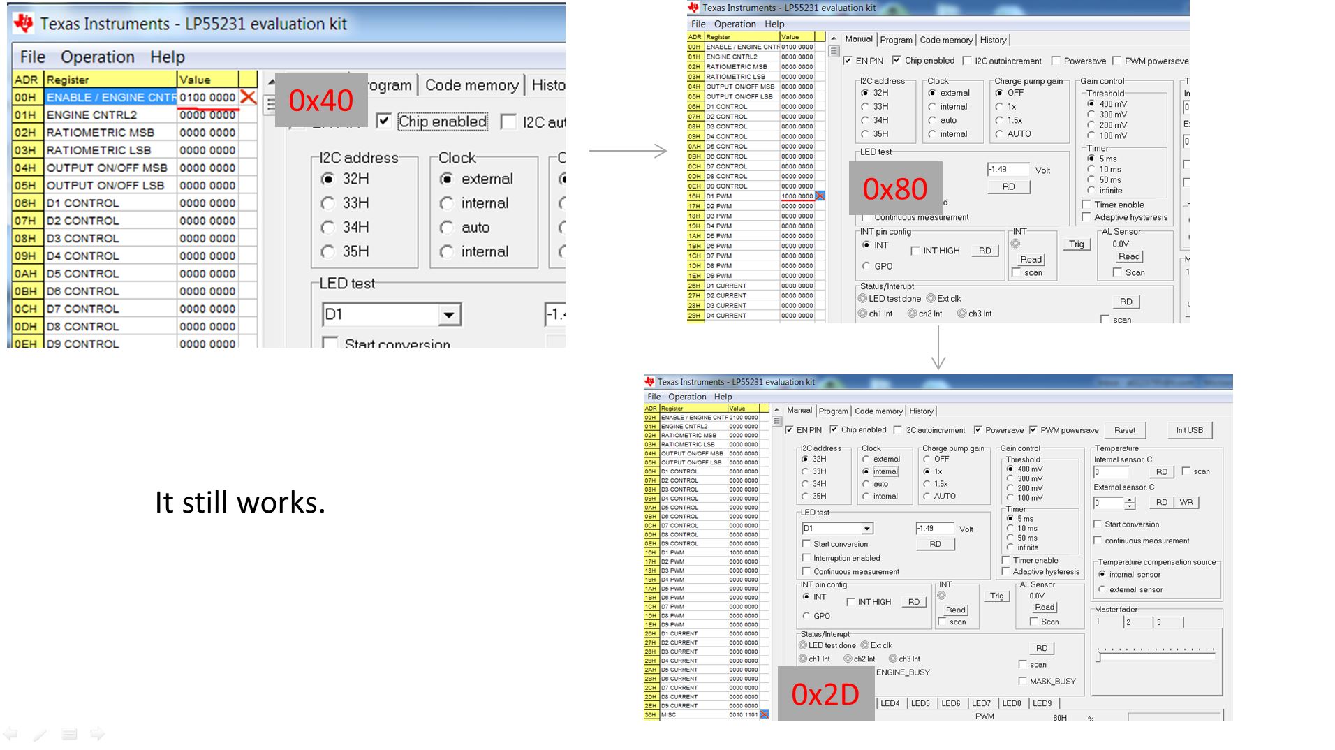

  • Hi, Matt,
    Actually I use the same code and process as yours.
    With register writes in this order:
    write_led_reg(RegEn, 0x40); //Enable chip (no program execution)
    write_led_reg(PWM1, 0x80);
    write_led_reg(MISC, 0x2D); //Charge pump forced off
    I get correct result and you can refer to the attachment.
    LP55231 test.pdf
    Are you able to get LP55231EVM to test?

  • Hi, Matt,
    My bad.
    See the new picture.
    Do you mind to send your schematic? Let's make sure we don't miss anything.
  • Hi Kenneth,
    The schematic was in the first post - this is all parts related to the LED driver. There are no errors in the PCB layout vs this schematic (this was my assumption when it wasn't working so reviewed a LOT!).
    Matt
  • So you actually have pull up resitors of SCL/SDA?
  • Hi Kenneth,
    Yes - pull ups on SCL/SDA. Issues with function of chip, not reading/writing of registers.
    Matt
