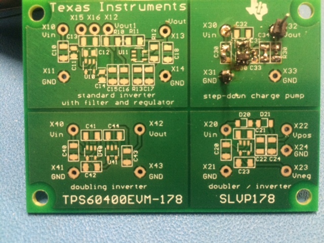

I cannot get a negative voltage at the output with 2.0V input. I got ~+0.3V instead.
I use 3 1uF cap at input, output and for Cfly.
The board is TI TPS60400EVM-178.

You have populated the step-down part of the EVM (see section 2.4 of the EVM manual). The output voltage will be positive, and half the input voltage (lower if the output is loaded). What are C34 and R30?
To get a negative voltage, use the standard inverter layout (see figure 2-2 in section 2.1 of the manual); the filter/regulator parts are optional.
