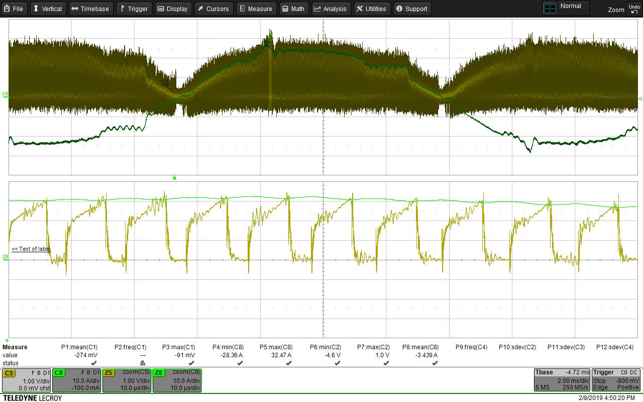

We are noticing an abnormal current spike on input current waveform at higher loads. Here is a picture of the waveform (Ch8=IinAC). We can see some distortion towards the top of current waveform.

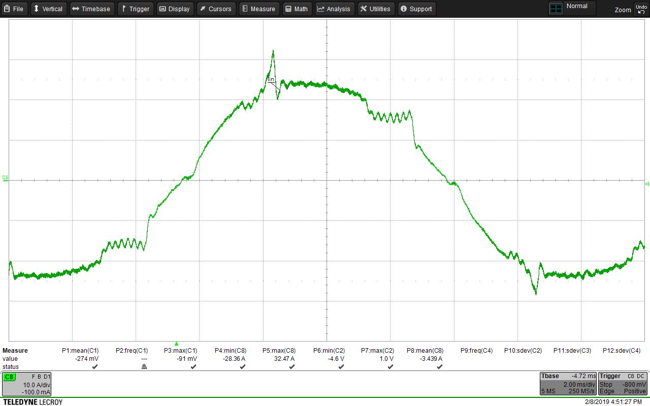

This issue only occurs at higher input currents. Here is another picture with current sense signal (pin 9 of UCC28070A). Ch5=CS pin 9 of UCC28070A, Ch8=IinAC. The current sense signal seems to be lower than peak current limit.
Things tried so far. Increased peak current limit. Added more filtering on CS signal. Modified current loop to reduce cross over frequency. Issue still persists. Please advise on possible causes of this distortion and things to check/modify to eliminate this.
