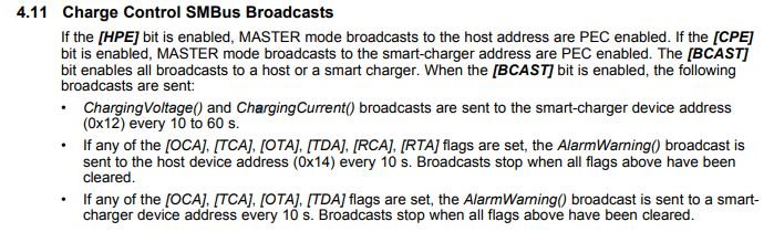

  • Hi Joel,
    thanks for your help.
    The smart battery was writing the charger current and voltage to smart charger. (i.e) the current value was changed.
    Please, find that screenshot of the datasheet reference below.
    will it change because of what is mentioned above?
  • Hey vel,
    The SMBus address of the charger is 0x12 so it is entirely possible the smart battery is writing to the I2C register of the charger and reprogramming the voltage and current settings.
    You should ask you smart battery pack vendor to describe the operation of the ChargingVoltage() and ChargingCurrent() broadcasts. We can only identify items on the charging side and cannot comment on the battery pack side.
