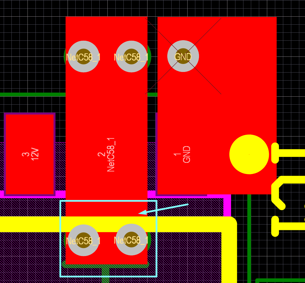

2. Is there a parasitic effect when using such a wiring? (current loops, electromagnetic pickups, etc.) I did so specifically in order to increase the distributed load current, because my calculations show that with a conductor width of 0.5mm, when using a base coating (18um) and copper deposited ~ ( 20um), with the presence of an internal plane (18um), with a distance (1.2mm) to it will be about 2.2A, when the converter itself is designed for a maximum load current of 3.0A. I do not have the opportunity to use the 35um, since this is due to the peculiarities of production specifically for this board. (minimum track width, clearance, etc.)

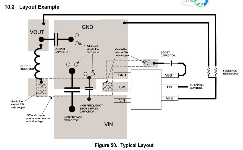

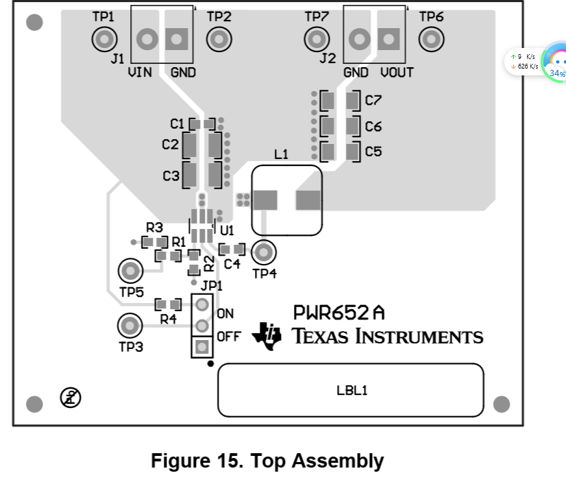

    2. The input cap needs to be close with the IC, and the SW trace should be as short as possible. So I recommend to use via for SW trace rather than GND. Please follow the layout in datasheet and EVM user guide.

    2. Will the next layout not have negative consequences?
    http://prntscr.com/mj1t5q

    2. Sorry I can't open the link. could you upload it?
  • 1. Accepted.
    2. Screenshot
  • Hi Evgeniy,
    It's good. Please place Cin close to pin 3 and pin 1.
