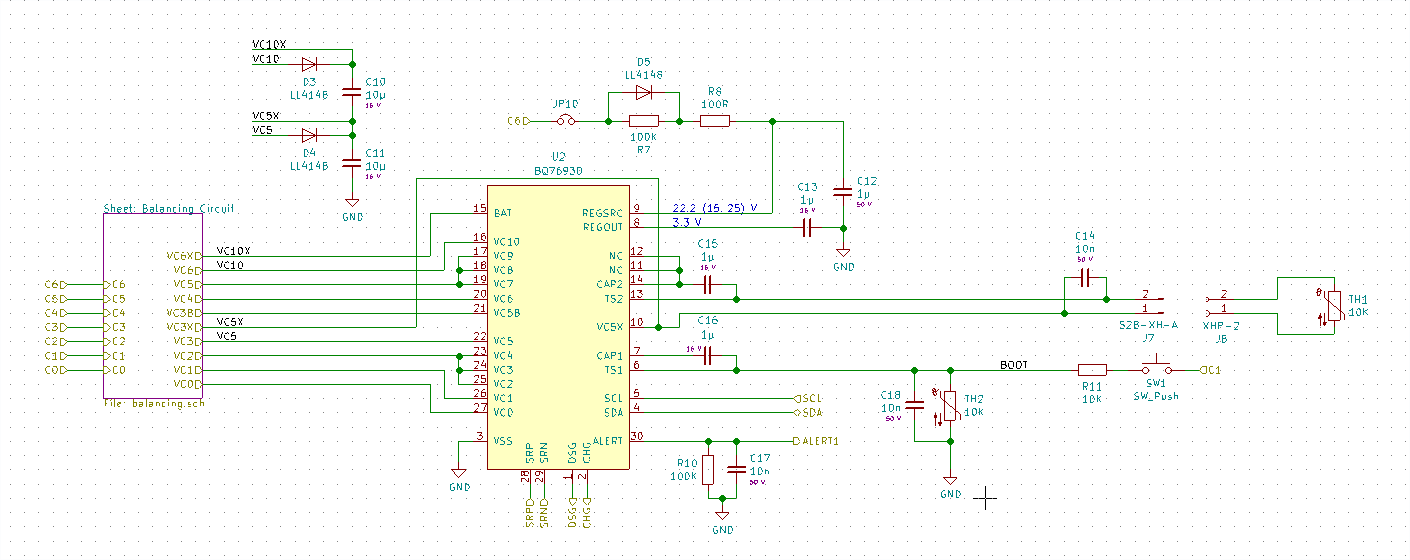

I am using a BQ7693006DBTR (no CRC) as an AFE for a 6s Li-Ion battery pack.
Although cell voltages read correctly, I am not able to activate any balancing circuit.
A few random remarks (not sure what is relevant):
  • the cells are connected as recommended in the datasheet (Table 8-2)

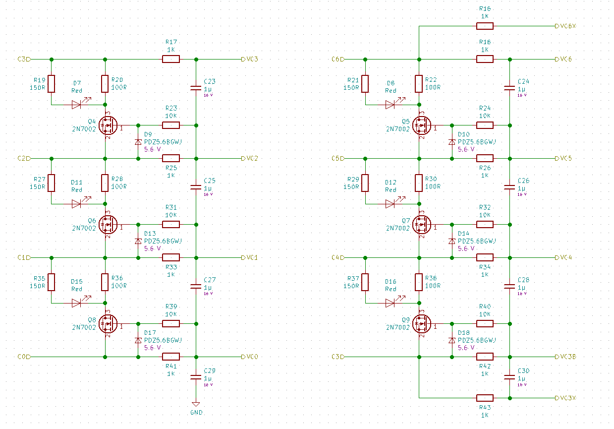

  • balancing should be achieved through an external N-channel balancing network like described in the Design Recommentations (Figure 6)
  • the balancing network works as expected when shorting the respective cell input pins (bypassing the internal balancing FET)
  • no fault is active in SYS_STAT
  • ADC is enabled (Bit 4 in SYS_CTRL1), CC is disabled (Bits 5-6 in SYS_CTRL2)
  • cell balancing bits (CBx in CELLBAL registers) read back as intended after writing

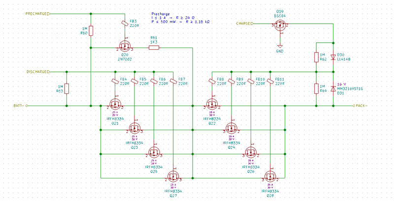

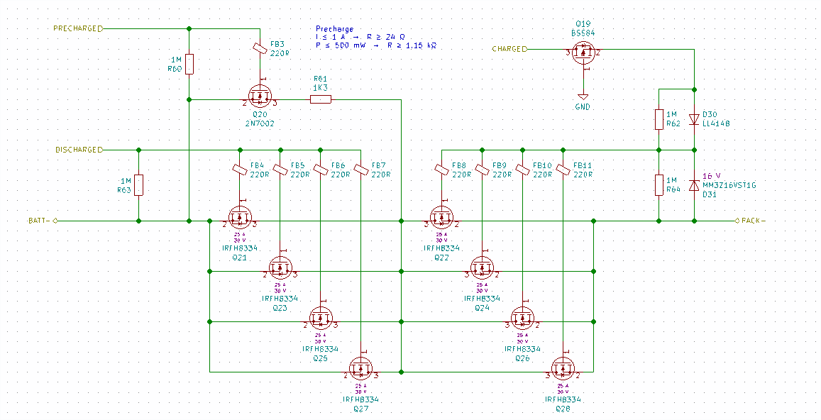

  • activating the CHG FETs work, activating the DSG FETs doesn't work (DSG_ON in SYS_CTRL2 reads back as '1', though)
  • load detection circuit works (LOAD_PRESENT in SYS_CTRL1)
Since both balancing and activating the discharge circuit don't seem to work, I suppose I've missed deactivating some kind of protection circuit, although I can't find any reference to anything similar anywhere.
What am I missing?

    I apologize, I missed your statement in the original post about SYS_STAT showing no faults. Can you send your schematic? From your description, the DSG FET should be on, so I am wondering if there is anything preventing the FET from turning on.

  • Hi Matt,
    sure, see below. It's basically the circuit from the Reference Design tiduar8b, tailored to our 6s pack.

  • Hi Lasse,
    The Precharge FET is grouped with the Discharge FETs. Is this intended? I don't think this is causing the issue you are seeing, but just wanted to bring it to your attention.
    From your schematic, I do not see anything that would prevent the DSG FET from turning on. I did notice that the signal names are different between the schematic pages: "CHG" and "DSG" become "CHARGE" and "DISCHARGE". Is there any circuit in between? Is it possible the DISCHARGE signal is shorted low? It might be good to measure the current into REGSRC to see if it changes when DSG is high vs. low.
    I also do not see any reason for balance not to work from the schematic. Writing 0x01 to the cell balance bits should cause the low cell to balance. A low impedance source is needed to see the current draw and for the LED to light.
    Matt
