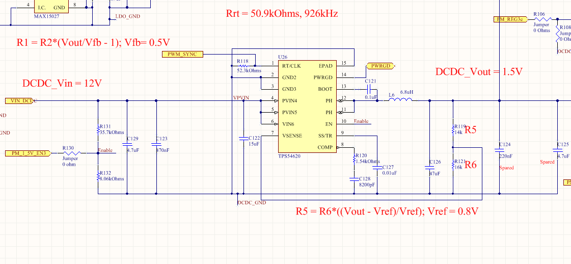

  • Hi John,
    The 1st converter starts up normally and regulates to the proper output. However, the 1st PWRGD remains LOW. Hence, the 2nd converter always remains OFF.
    VSENSE = 0.799V which is within 94% to 106% of VREF (= 0.8V).
    I would provide the schematic, but since we have a lot more than just 2 TPS54620 circuits and they are in a hierarchical patter, it might be too confusing to describe. I can assure you that it is equivalent to the manual though.
    Kevin
  • Here is the schematic for the TPS54620. PWRGD goes to the EN of the next TPS54620 (not shown).
  • I resolved it. I removed R131, but not R132. The 8kOhms resistor was pulling down the PWRGD pin. I had assumed that the 8kOhms resistor was big enough to not be able to do this. Thank you for your help!
