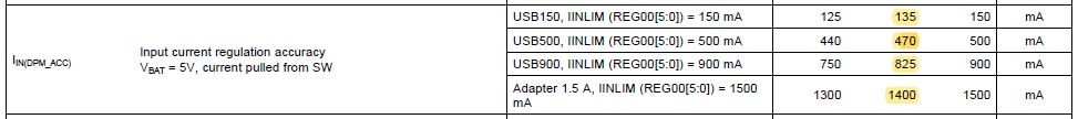

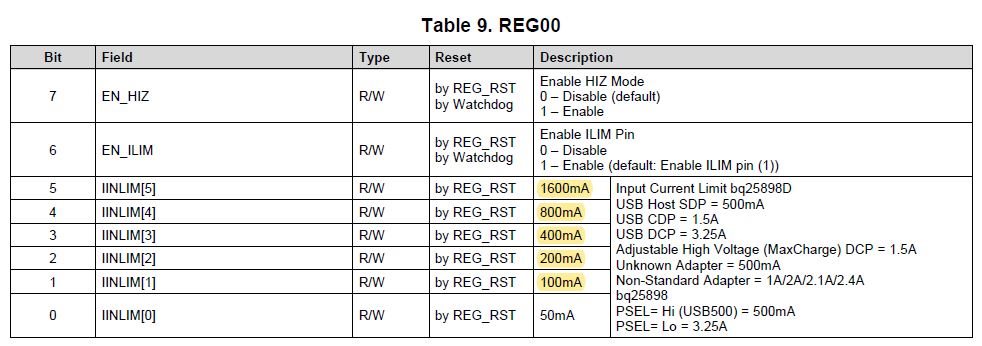

Our customer asked if REG00 IINLIM setting had 100mA offset. When I have checked in datasheet, the specification describes
However the register map REG00 describes
The customer mentioned IINLIM is roughly 100mA shifted.
Could you suggest us how we think about these differences.
