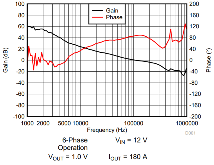

From datasheet I found Phase line does not across 0, therefore Gain margin cannot be obtained. Could you please tell the reason why DCAP3 control topology has this kind of characteristic? Thank you very much!

    I saw it in TPS53667 datasheet Page 107. The customer wants to know the gain margin, but without phase crossing 0 it it hard to know. Thanks!

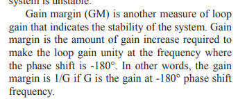

  • Hey Wenhao,
    For gain margin you're actually looking for when phase crosses the 180° point rather than the 0° point (see below from SLUP386).
    For the bode plot you're referring to in the TPS53667 datasheet, all it's saying is phase doesn't hit that point before 1MHz, the upper limit of the plot. At that point, with the TPS53667 loop bandwidth only at 100kHz, the gain margin would entirely depend on the output capacitance and board layout.
    Multiphase designs typically deal with high current transients which require a lot of output capacitance to keep VOUT within the design targets and the 667 is no exception. That high COUT value keeps the gain margin point at high frequencies which typically aren't a concern in power supplies.
