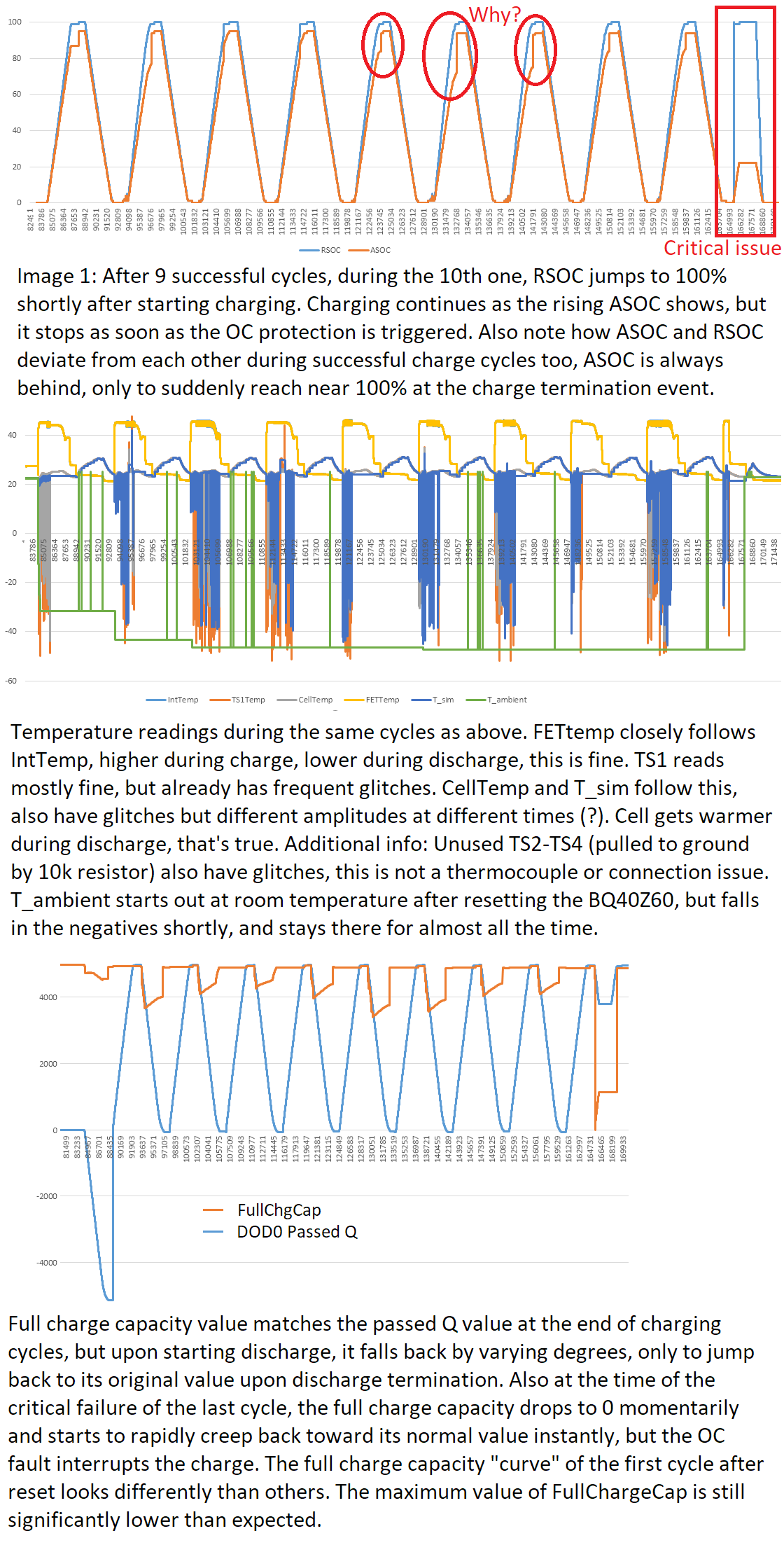

One is simply that the full charge capacity of the pack is showing up low. We usually get something around 4500mAh displayed in bqStudio although it should be 5200mAh (2x2600mAh). Sadly it’s valid and not just displayed incorrectly, manually integrating passed charge gives the same results. Cell Qmax values are always over 5500mAh. I’ve already been playing around with IT gauging config settings, but it did not help. The only way I was ever able to raise full charge capacity to still a bit below 5000mAh, is by raising charge end voltages to (or even a bit above) 4200mV after doing the learning cycle at a 4100mV setting. It seemed like if the learning cycle is already done at a 4200mV setting, we get the same low capacity. Regarding chemistry, there are 2 different IDs for the ICR18650-26F (0137, 1165). Which one is supposed to be used? Do you have any other idea that can cause a problem like this?
The other issue we’ve observed, is that during charging, RSOC sometimes jumps up a rather large step to 100%. During discharge, gauging is perfect. We could live with the incorrect RSOC display, but this artifact makes the overcharge protection unusable, since charge passed after the RSOC=100% mark is considered overcharge even though ASOC is still lower and climbing. If we set the OC threshold to a reasonably low value, it is going to be triggered and cause a safety status shutdown. Again, playing with IT CFG settings regarding RSOC manipulation solved nothing. Something suspicious I found, is that the T_sim and T_ambient temperature values are often in the deep negatives, -10 to -50°C even though TS1(cell temp) and T_Int reads correctly (around 26°C room temp). And reading through the logged data, the RSOC jump to 100% sometimes coincided with a jump or glitch in some of the temperature values. Any idea for this?
I’m attaching an image to back up what I’m describing. Really looking forward to a suggestion how to solve (or workaround) these issues.

    You have not done your chem ID characterization on the cell. I see that your programmed chem ID is 1210. It should be 1165. Please reprogram it, run a learning cycle and then test it.

    The end result came out tragic, worse than it was before. Full charge capacity is at the same low level as before. Overcharge protection would still kick in if I enabled it. Also, the charge current is now too low and constantly drops during charging, not just at the very end as expected. And the ACFET starts cycling towards the end of the charging cycle. I've recorded the first CHG - DSG cycle, with some graphs on top highlighting the worst items. Could you please check it out? I'm also attaching the corresponding srec file.

    A little update since my last post: My full charge capacity is still not the best, but at least the glitches and random issues seem to go away. This is the benefit of correcting a hardware issue, one that actually has been carried over from the bq40z60EVM board. In my opinion, the voltage feedback divider resistors used there (332K / 26.1K) are not well suited for a 4S battery pack. Although we're technically just inside the charger voltage regulation range specified [0.61V - 1.22V], the internal voltage register can't be set properly as its value would have to be above the 255 limit. Now with a [330K / 22K] divider and a recalculated minimum voltage output / voltage resolution pair, the ASOC and RSOC do not diverge from each other during charging, triggering an overcharge status, but stay closely together. Full charge capacity is also a bit higher than was before, still below 5000mAh though, but at least it doesn't vary all that much during a cycle. These are already nice improvements.
    Now one last question you might be able to answer: is there an "upper term voltage" kind of setting somewhere in the charger to set the voltage for 100% RSOC display? Like there's one for the minimum voltage. Now as I've written, now my ASOC and RSOC are the same value almost all the time, but they seem to top out at 90% with a fully charged battery (multimeter verified), and then jump to 100% at charge termination. This is technically not a problem but not nice to show to the user.
