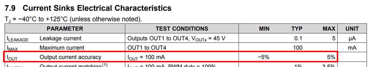

Current accuracy is specified ±5% as below.
Does this parameter have aging variation?
Kuramochi
Kuramochi
The parameter does not change over time.
