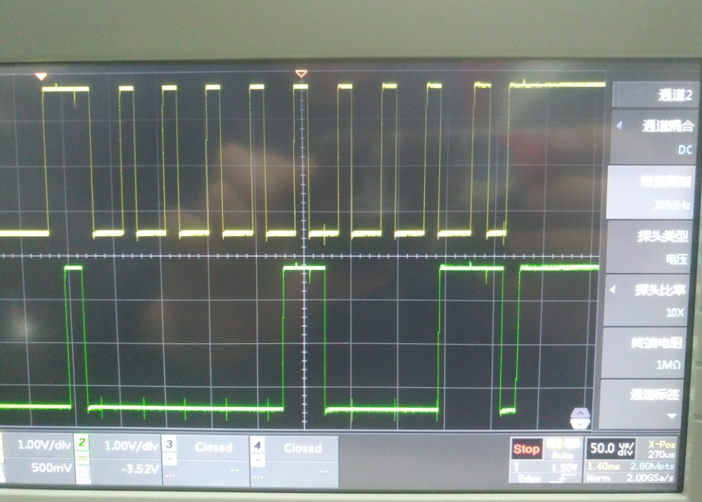

     BQ7694003 Measured REGOUT = 3.3 V.Cap1 - VSS cap2-VC5X cap3-VC10X are all 3.28v.But I2C has not been successfully communicated, and AFE does not respond on SDA, as shown in the figure below.Communication time should be sufficient.
What is the reason for this?
Is the device damaged?

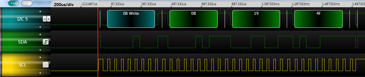

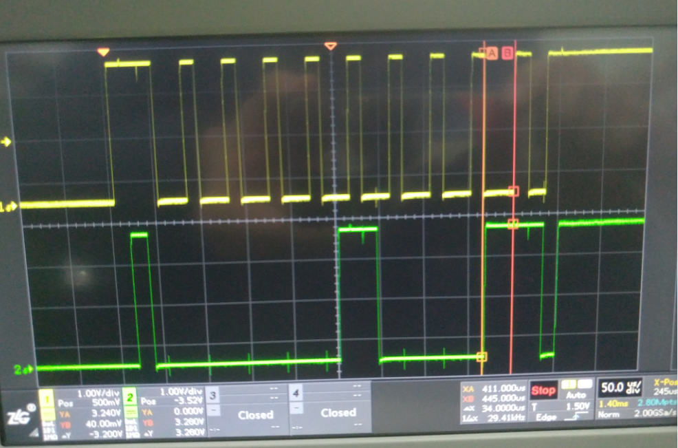

    The following is the waveform on I2C oscilloscope. Is it correct?
    • The following is the waveform on I2C oscilloscope. Is it correct?
  • Hi Timsen,
    From the waveform it looks like you are writing the address 0x0000100, which would be 0x04. This device has a 7-bit address, but I think you may be trying to use 8 bits?
