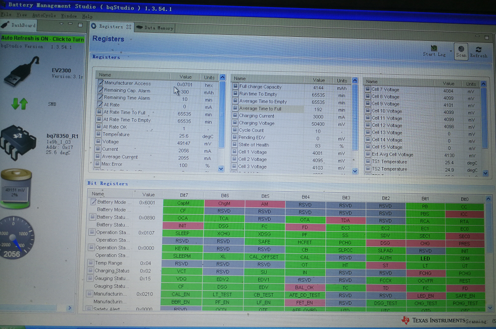

I have just made a BMS with bq78350 ,bq76940 and 12 batteries.
The full voltage of the batteries is 50.4V.
However, when the voltage drops to 49V, the capacity has drop to 0  which is showed as below.
Is anything wrong with my BMS.
Is there a way to fix it?
Besides, the voltage of all batteries and the current have been calibrated according to the manual.

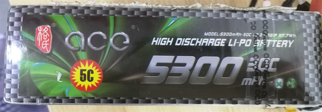

  • Matt, thanks a lot.
    How to get the chemID of the battery?
    Just have a look at the battery listed as below.
    This group includes six batteries in all and the BMS is made up of two groups.
  • Hi Wu,
    I do not see this specific battery in our ChemID database. There is an online tool (GPCCHEM) that can help you find the closest match: http://www.ti.com/tool/GPCCHEM There is also a video if you scroll down to the bottom of the GPCCHEM page to go along with the written guide.
    For some gauges that use Impedance Track technology, find the best ChemID is very important for gauging accuracy. For the BQ78350 (CEDV gauge), the ChemID is only used to determine initial conditions when the device is fully reset. It is used to best estimate the SOC from the voltage only. However, once the gauge is operating, it does not use the ChemID. Depending on your application, it may not be very critical.

  • Matt, during the charging process, the capacity is increasing. However, when the system is reset, the capacity just drops to 7%. For the discharging process, the capacity is also decreasing. However, when the system is reset, the capacity just drops to 7% too. Besides, the voltage is near 49V. Is it normal? Is there anything wrong with the system except the wrong ChemID ?
  • Hi Wu,
    If the capacity is showing as 7%, it might be because the voltage of one of the cells is below the EDV2 voltage setting in data flash. Or it could be related to the ChemID.
    To help debug the issue, can you send your data flash settings (.gg file) and a log of your charge and discharge with the resets?
    To save the dataflash settings, click on the Export button on the Data Memory window.
    To save a log file, click on the 'Start Log' button on the Registers window:
    Matt
