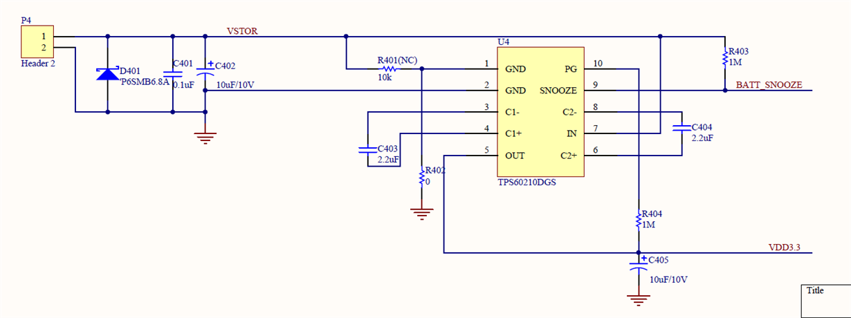

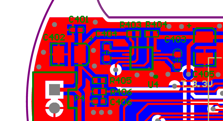

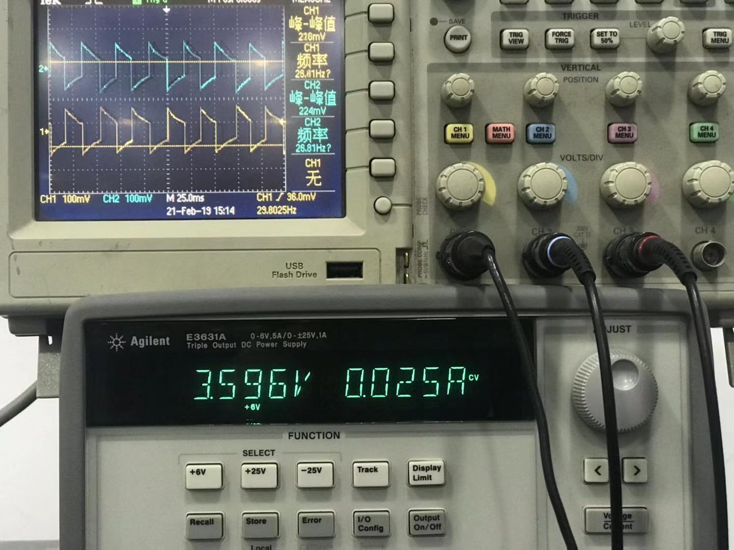

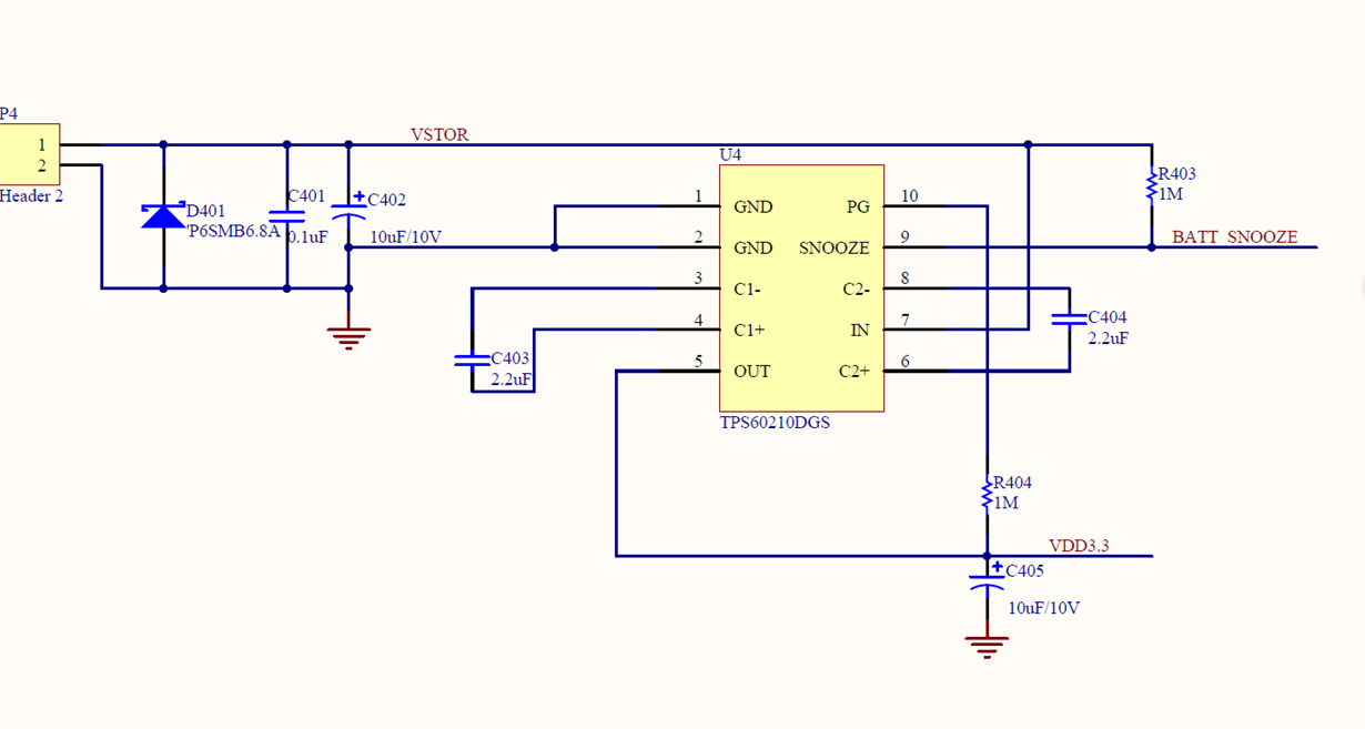

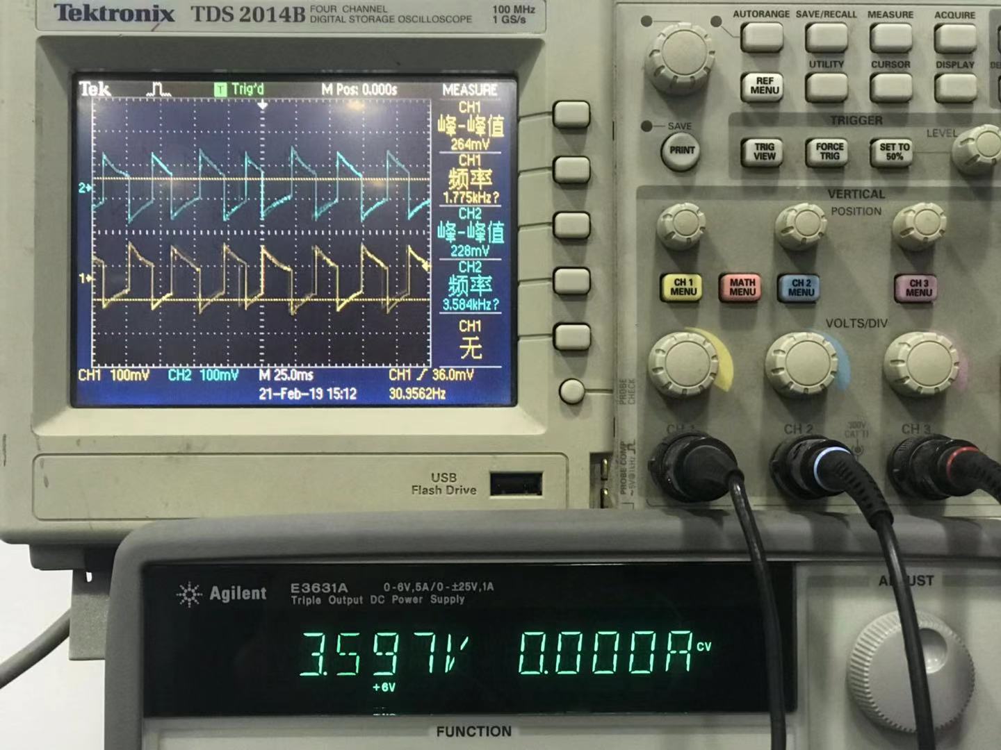

Hi guys
When charged the regular pump  ,TPS60211 with the lithium battery ,this device costs about 20 mA  abnormal current without load from battery   .The datasheeet says  in snooze mode , typical 2 uA ~2mA output current will cost .cbviously this device does not work well.
