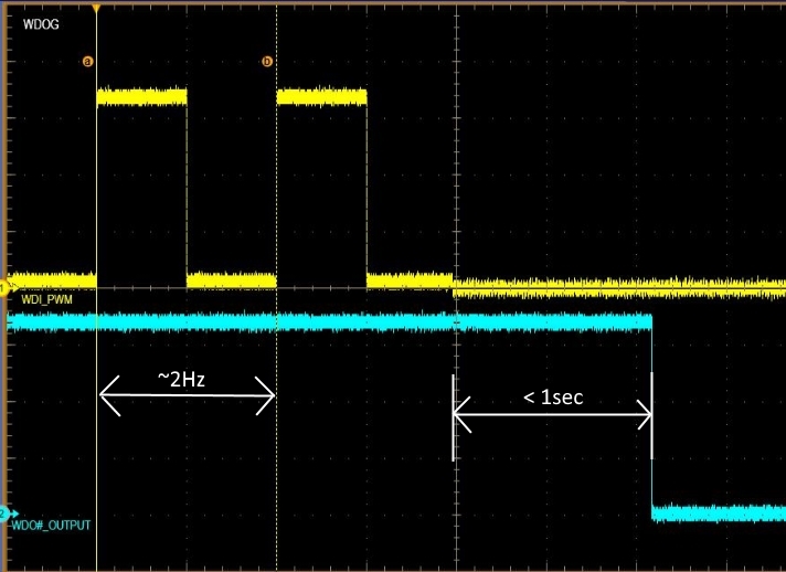

  • Hi Ethan
    When a failure occurs, I need to complete the circuit protection mechanism in one second.
    I think this is the upper limit of tWDU(max)
    But because of the system boot delay, I also need a tWDL (min)
    So I need to adjust the circuit design. Let the valid window range be between 0.5~1 seconds.

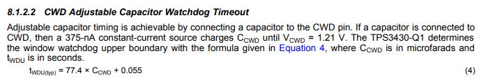

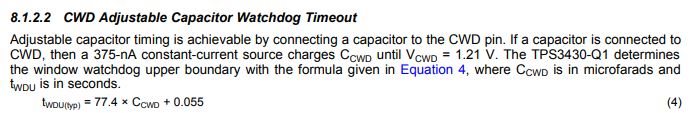

  • Hi YenHung,
    You can change the timing of the upper limit by attaching a capacitor on the CWD pin. The section below from the TPS3430-Q1 datasheet shows the formula on how to calculate it. The lower boundary are fixed based on the value of SET1 and SET0 pin. The ratio allows the lower boundary to be 1/8, 1/2, or 3/4 of the upper boundary.
