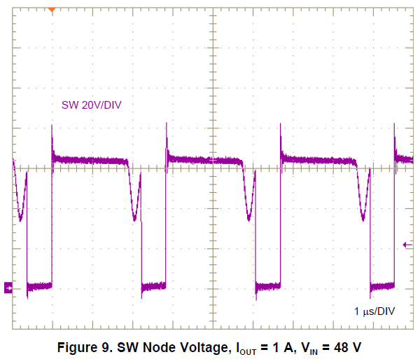

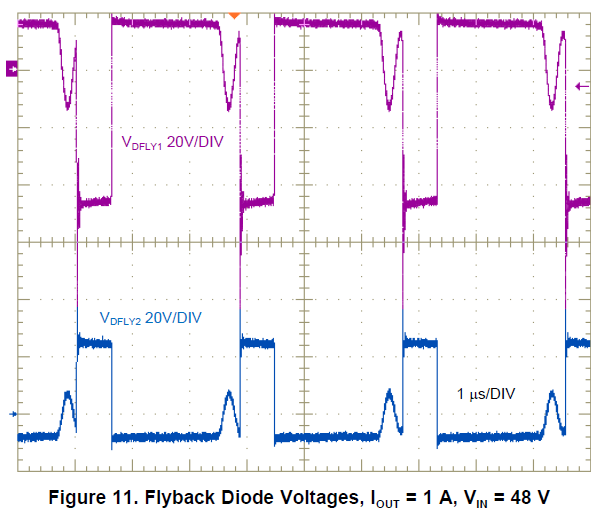

Hello Team,
In Figure 9 and Figure 11 of User's manual , why SW Node Voltage and Fly back Diode Voltages drop once?
I want this causes and solutions.
Hello Team,
With the LM5180 in BCM operation, switching occurs near the valley of the SW (and diode) voltage oscillation. However, swithcing in DCM (fixed at 350kHz) can occur anywhere during the ringing period, depending on the load current level.
Tim
