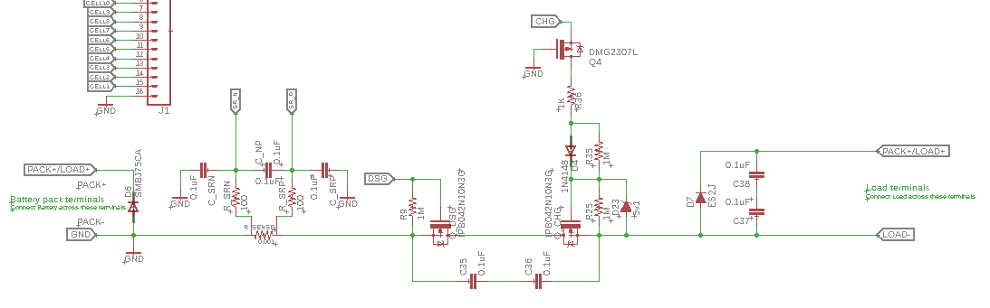

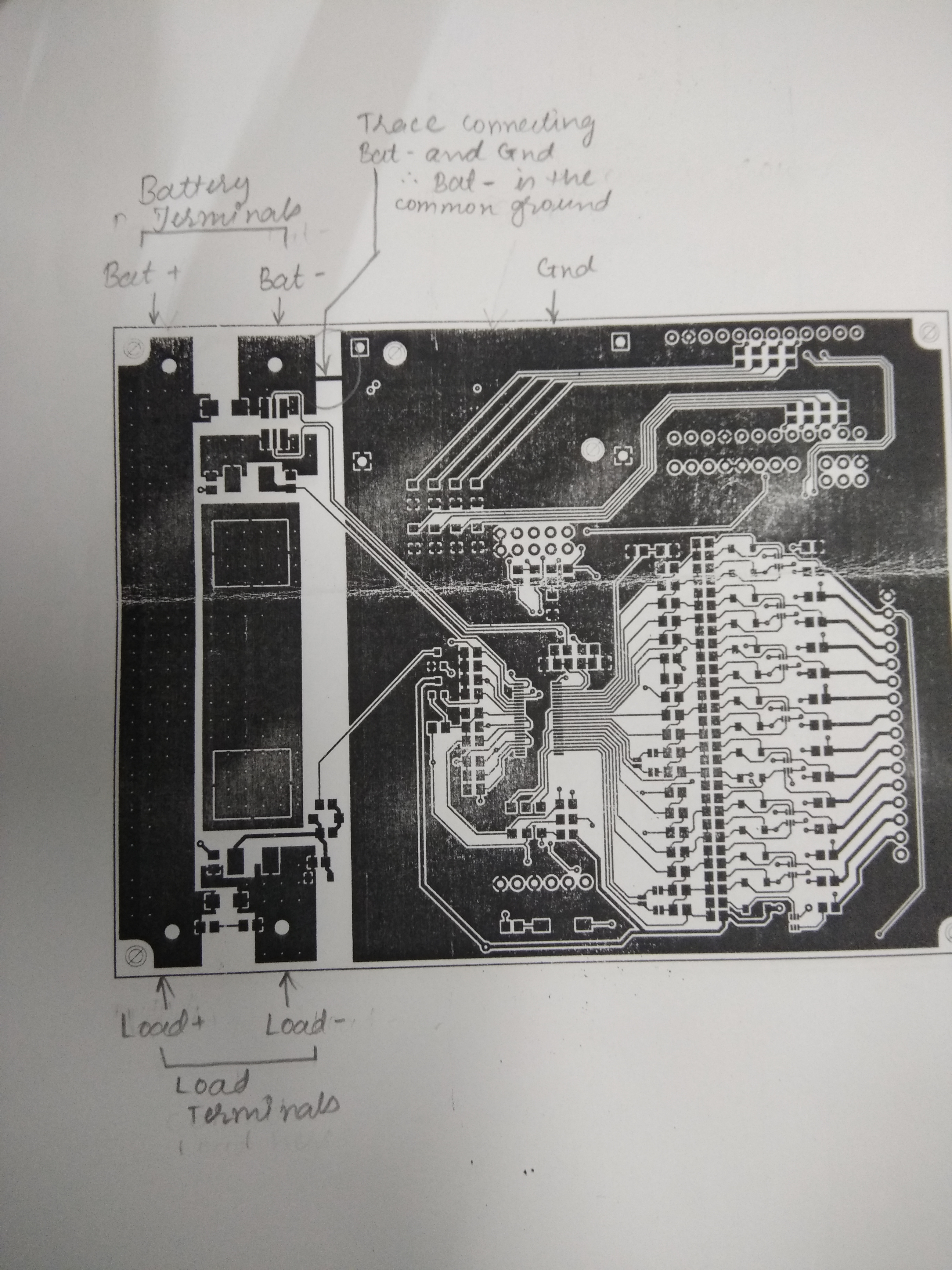

  • 4. Is Load- and Bat- shorted? (refer image connection.jpg)
    The EVM board had two pairs of terminals - PACK terminals and BAT terminals. I understand that across one set of terminals, LOAD will be connected and across the other set BATTERY terminals will be connected. Hence I call these 2 sets as (LOAD+, LOAD-) and (BATT+, BATT-). My question is, is the LOAD- and BATT- shorted? In some designs I have noticed that the LOAD- is not connected to GND . (refer the image CHG DSG section.png)

    4. Load- and BAT- are not shorted. The bq76940 uses low side current sensing through a low value resistor. On the EVM low side protection switching is used, like your schematic section. So Load- (or PACK-) and BAT- can have a large voltage difference during protection. On the EVM the VSS for the bq76940 connects to the BAT- net so that large currents push the sense pins positive rather than negative, the pins have a larger positive range. On the EVM BAT+ and Load+ (or PACK+) are the same net.
    On other designs high side switching is used to make ground referenced communication more practical. In these systems BAT- and Load- are still not shorted since the sense resistor is between them. It is a small resistor, but important.
    The thin trace between BAT- and GND connects the signal reference (GND) for the ICs and circuitry to the BAT-. One view of electronic circuit design which is followed with the EVM is that high currents should be directed away from low level sensitive circuits. That is forced with the net-tie or narrow connection such as you have shown. It does not need to be so small, but high current should not flow through the low level ground causing reference level differences in sensitive circuits.
