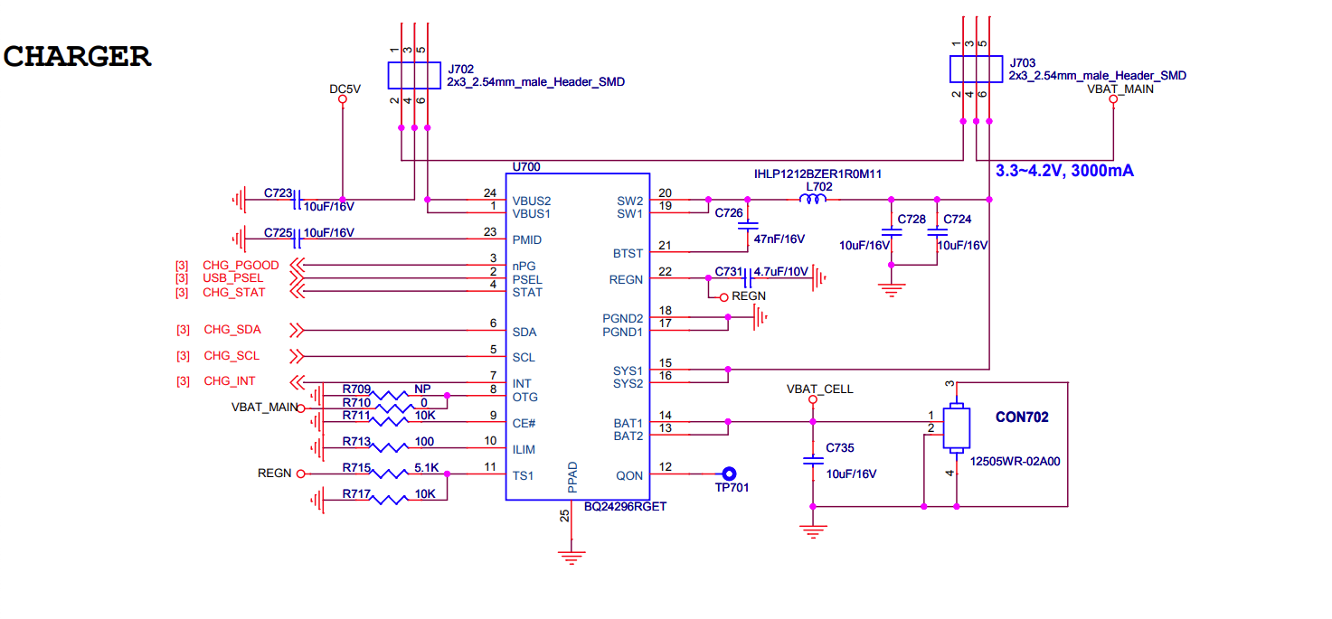

  • Hey Andrew,
    There is a TS fault present in all of your register readings. This means the voltage at the TS pin is not within the specified "normal" range, which makes the charger think that the battery is too hot. Charging stops here.
    I would check your resistor network on the TS pin and make sure the voltage on that pin, as a %REGN voltage, is between the VLTF and VHTF thresholds as specified in the EC table.
    Joel H
  • Joel,
    Thank you very much for pointing this out. I do not have a thermistor on the board.
    Please see the schematic below. I have a volatge divider, I got this circuit from the Artik Platform board.
    As you can see they use a regular 10k resistor. My plan right now is to remove that 10k resistor in place of a 10k thermistor.
    I have since ordered some thermistors from Digikey.
    Will this work?
    AJ
  • Hey AJ,
    We do not recommend just a single 10k thermistor to ground. I'm going to refer you to both Figure 17. TS Resistor Network and Figure 18. TS Pin Thermistor Sense Thresholds in Charge Mode of the datasheet for the proper reference for the TS pin configuration. The TS pin should be a percentage of the REGN voltage, as spec'ed in the EC table of the datasheet.
    If the TS voltage falls outside of certain percentages, it will flag the charger with a TS_COLD or TS_HOT flag. You can refer to the end of section 9.3.3.3 Thermistor Qualification for the standard values we use based on an 103AT NTC thermistor with Beta_25/85 = 3434
    Joel H

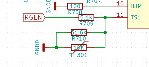

    The circuit on TS pin is now:

  • Hey AJ,
    This may sounds trivial, but are you measuring the REGN voltage and TS voltage directly at the pin?
    If this is true, then we may need to look to see if anything is happening transiently on an oscilloscope. You will want to put your probes on REGN and TS to see if any oscillation is occuring. We will also want to look at the charging current if possible on the same scope capture and/or /INT pin of the charger.
    Joel H

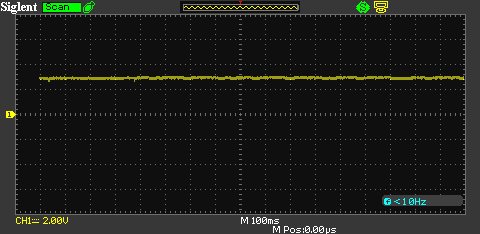

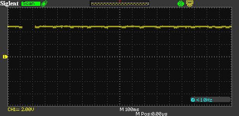

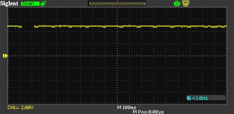

  • Joel,
    Checkout these screen shots from the Oscilloscope.
    REGN:
    TS Pin
    I hope these help!
    AJ
  • AJ,
    Please set REG01[4]=1 to enable charge and try again.
    Ning.
