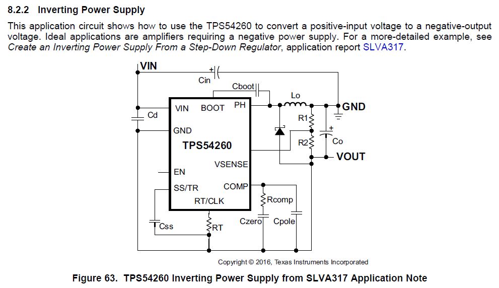

Hello
I use the TPS54260 for Inverting Power Supply .
But Not Disable when EN Pin Connect the GND.
How do I use EN Pin for Disbale the Device?
Regards.
