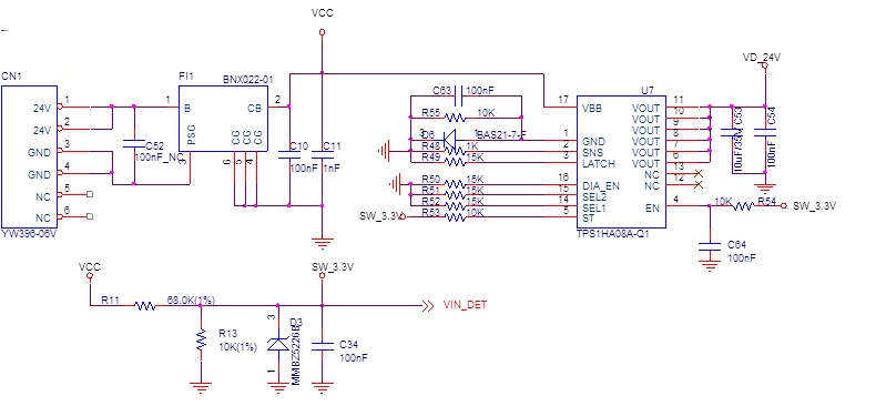

6. Requests :
    1) schematic Review
    2) Do you have a TPS1TA08-Q1 product?
         In the data sheet, 12V is TPS1HA08-Q1 and 24V is TPS1TA08-Q1.
    3) Please ask us if it is appropriate for the structure we are using.
7. Below is the schematic we designed & waveform.

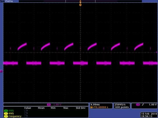

* Waveform of ST pin designed according to circuit diagram

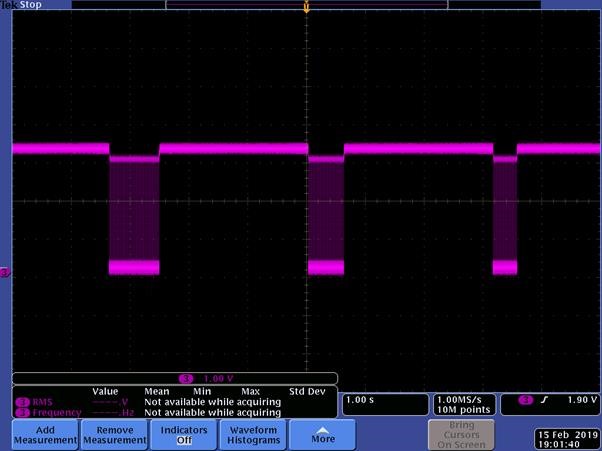

When the diode of GND is removed and 4A Load is given, the waveform (ST Pin)
Please review.

    Can you give me a current measurement on the output? I am wondering if there is any type of inrush currentsince this is LED backlight I assume it would have some decent sized capacitors?
    Also the resistor divider method that you are using for the 3.3V rail is not ideal as during start up if VCC gets pulled a little bit lower then it will not be high enough to keep the enable pin high. to test this I would recommend supply a separate 3.3V rail and see if it fixes this issue. Could you get a waveform of VCC like you did for ST to see what it is doing during the turn on time and see if it is falling below where your resistor divider is no longer high enough to keep the device on.

    We modified the circuit of EN pin and tested it.
    However, there is no improvement.
    If EN is set high after stabilization after power is applied, fault will occur.
    It seems to be a problem because EN is not set to Soft Start when it goes High.
    We have LCD back light connected to the load.
    Did you find any problems in the schematic other than the EN circuit?

    What is the capacitance on the input of the LCD display load?
    Can you please send the current waveform when you power it up? Do you see an inrush profile that is causing the device to current limit?
    The capacitance of the LCD panel backlight is unknown.
    Is the waveform of the current when the power is on?
    Tested with adapter and power supply.
    The adapter has failed each time and the power supply has not failed.
    However, it has been confirmed that if the EN is turned on / off, the same error occurs.
    Thanks.
