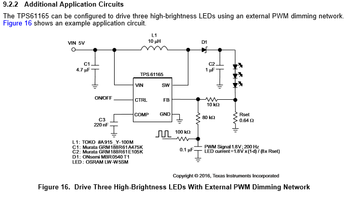

TPS61165: TPS61165 Consulting
Part Number: TPS61165
Hello
Application: Vin=5V ,Vout=20V,Iled(max)=150mA, need Enable and PWM dimming function
I want to check if it could be implememted by Figure 16 SCH ? using CTRL as Enable/Disable PIN, PWM dimming through inject to FB pin like Fighure16
and how to calculate Iled ? equation is LED Current =1.8V*(1-d)/8*Rset ? what's the meaning of d ?
while I want to check the recommended range of  PWM frequency and voltage ?
  • Hi Fandy,
    Yes, you can configure as this way, for 150mA, you need to change the Rset=200mV/150mA=1.34ohm, d is the duty cyle of your pwm signal. 1.8 is the ampitude of your pwm signal. You need to make sure your PWM voltage on FB will not exceed 200mV. And the frequency should be less than 1kHz. You'd better verify again with certain frequency.
    Sean
