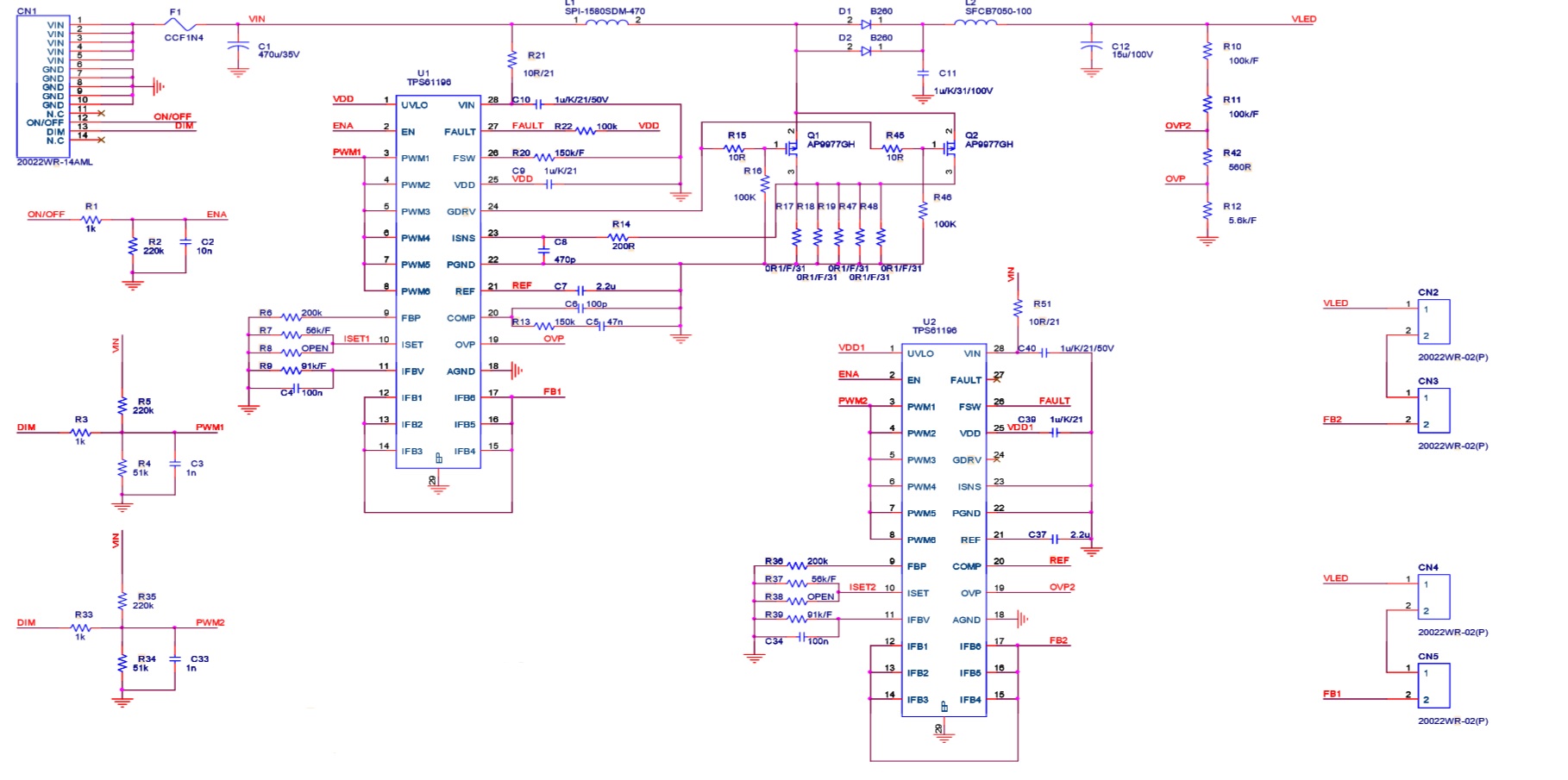

We implemented TPS61196 in multi-chip operation.
But there is a problem.
The spec we want to implement is as follows.
Vin = 24V
Vo = 36V
Io = 550mA x 2chip (550mA is IFB1 to 6 Total)
If only the master operates, it will operate normally.
However, if the master / slave is operated, the IC will make a sound and the input and output current will continue to change,
causing the FET to malfunction and the fuse to be cut off
Please attach the circuit diagram and check whether there is a problem.
Thanks.
  • Hi Youngsu,
    The schematic seems ok from my side, What's your mean of "the IC will make a sound and the input and output current will continue to change" can you provide some waveforms about this situation? and can you exchange the master and slave device to see is this phenomenon still exist? And what's the relationship between PWM1 and PWM2? I don't have much more commons on this, But I hope you do more test.

  • Hi Younhsu,
    I mean you can try to exchange the master and slave device to make sure each device can work correctly. You need to make sure each device is good.
    yes, you can combine PWM1 and PWM2 together;
    I want to know the Vin, Vout, Vsw, and output current and inductor current.
    Sean
