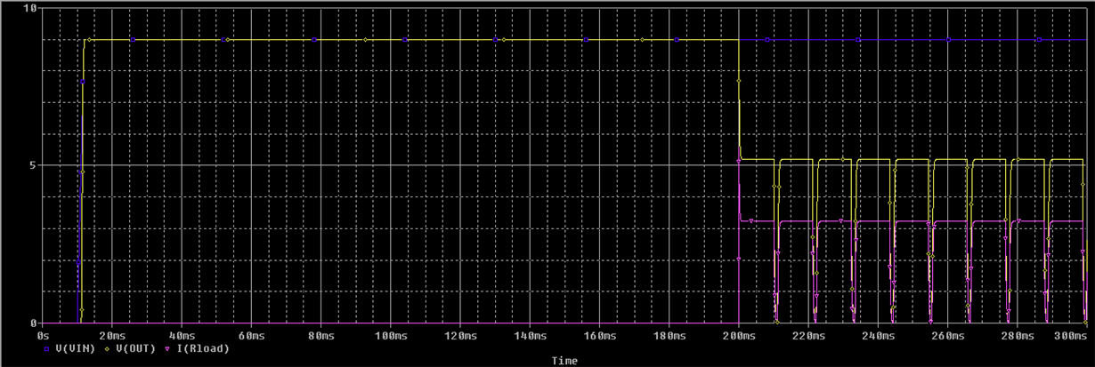

    Simulation Results:
    I ran the simulations, using a 1.6Ohm resisitor as the load. I've got  a switch (U3) that closes at 200ms to "turn on" the load separately from the Vin startup.  I see what looks almost like a pulse-width output on these waveforms, also not what I expected. In the case of my actual circuit, this also is not the exhibited behavior-- the voltage Vo does not come back up after dropping out.
    My actual load is a thermoelectric module, for which I cannot find a pspice model, so I used a resistor here instead.
    In order to make a waveform that mimics the behavior I'm expecting, I changed the Rload to 2.6ohms, and got the following, which is in line with what I'd expect to see:

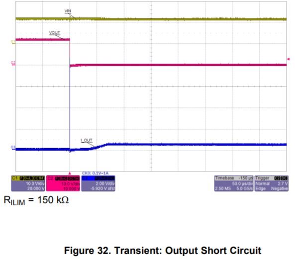

    • During an over current event, the load current will be limited to the value programmed by RILIM. There is a tolerance for the current limit as shown below. Please measure the steady state current during current limit  rather than the peak current. Also please consider the tolerance of the RILIM resistor that you have used.
    • The short circuit waveform in datasheet shows Vout=0.
    • Let us consider that you have selected RILIM=82k. This makes the ILIM 3.1A. Consider Vin= 9V.
      • Now, when you connect a load of 1.6 Ohms, the current that should be flowing in the FET before it starts to current limit is 9/1.6 = 5.62 A. As this current is greater than ILIM, the device limits the current to 3.1A. To achieve this the FET resistance is increased. If you calculate the FET resistance has to be 1.3 Ohms to limit the current to 3.1A (9V/3.1A = 2.9 Ohms, 2.9Ohms - 1.6 Ohms = 1.3Ohms).
                   The voltage drop across the FET would be 3.1A x 1.3 Ohms = 4V. This means Vout = 5V (9V - 4V).
          Now, the power loss in the FET would be 3.1A x 3.1A x 1.3 Ohms = 12.49W. Considering a 35 C/W of thermal resistance, temperature rise over            ambient would be 12.49 W x 35 C/W = 437.255 C which is way above the thermal shutdown threshold of 150C. So, the IC shut down. Since you            are using TPS259241  which is an Auto retry part, the FET tries to turn ON once the temperature falls 10C below 150C.
      • Now, when you connect a load of 2.6 Ohms, the current that should be flowing in the FET before it starts to current limit is 9/2.6 = 3.46 A. As this current is greater than ILIM, the device limits the current to 3.1A. To achieve this the FET resistance is increased. If you calculate the FET resistance has to be 0.3 Ohms to limit the current to 3.1A (9V/3.46A = 2.6 Ohms, 2.9Ohms - 2.6 Ohms = 0.3Ohms).
          The voltage drop across the FET would be 3.1A x 0.3 Ohms = 0.93V. This means Vout = 8.1V (9V - 0.93V).
          Now, the power loss in the FET would be 3.1A x 3.1A x 0.3 Ohms = 2.88W. Considering a 35 C/W of thermal resistance, temperature rise over              ambient would be 2.88 W x 35 C/W =  100 C. Adding Ambient temperature of 25C, the total junction temperature is 125C  which is below the                  thermal shutdown threshold of 150C. So, the IC wouldn't shut down.
    The calculations are inline with what you see in the simulation.
    So, Vout is dependent on the drop in the FET which is dependent on Vin and Load.
    The shut down of the FET is dependent on the internal FET junction temperature which is dependent on the power loss in the FET.
    Hope, I answered your questions.
