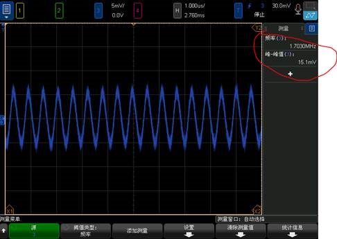

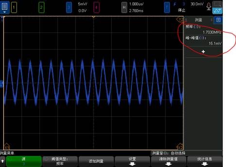

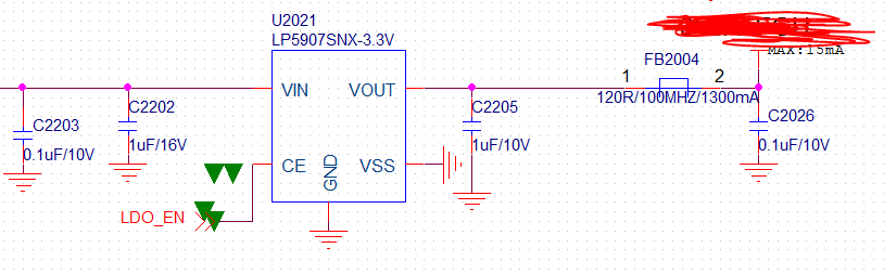

Customer change 0402 cap to a same value 0201 cap, and find 1.6MHz 15mV ripple. He added a 0.22uF cap in parallel and this ripple disappear.
Datasheet require output capacitor range is 0.7uF to 10uF, and output capacitor ESR range is 5 to 500mOhm.
1. As impedence and ESR of capacitor is related to frequency, which frequency is specified by datasheet?
2. As specification is same for these two cap below, what's the cause of ripple?

  • Hi Jeff,
    Please keep in mind that the LP5907 datasheet specifies an output capacitance range for stability of 0.7 to 10 uF. A 1 uF capacitor will not necessarily have 1 uF of capacitance under the application conditions. For more information about capacitor vs capacitance, please refer to Chapter 2 of our LDO Basics E-Book:
    www.ti.com/.../slyy151.pdf
    ESR specifications for LDOs are given at the resonant frequency for the capacitor. This is the lowest point on the capacitor impedance curve.
