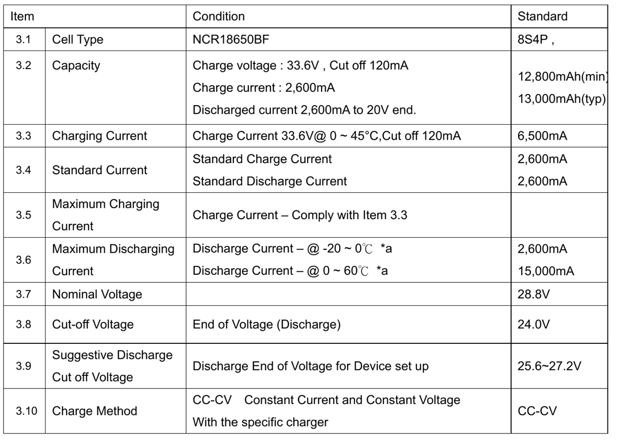

I found that the value of capacity register are not expected.
At first, the voltage I get is 0x6ff2 = 28658mV which is almost in full charge and the current is 0x1dc = 476mA.

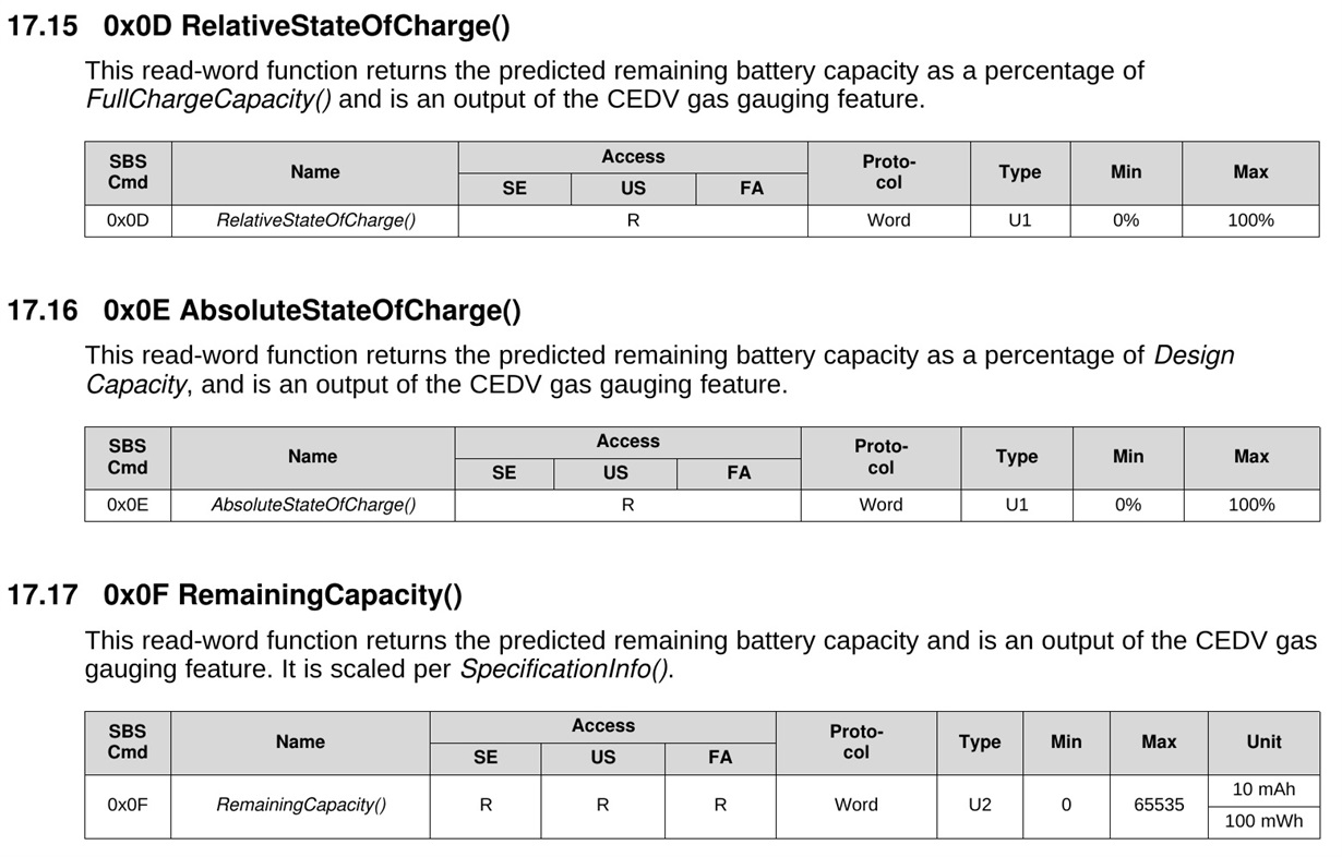

Then, I try to get some capacity information below.
/ # i2cget -y 107 0x0b 0x3 w -f
0x6001   => This is battery mode. The CAPM bit is set to 0 which means the capacity will report data in mAh.
/ # i2cget -y 107 0x0b 0xd w -f
0x001a   => 26% ; This should be close to 100%.
/ # i2cget -y 107 0x0b 0xe w -f
0x001a   => 26%This should be close to 100%.
/ # i2cget -y 107 0x0b 0xf w -f
0x0d81   => 3457 * 10mAh = 34570 mAh ; This is over SPEC so much.
I think the i2c commands work well because the value of voltage and current are what we expected, but not sure why the value of capacity are not.
