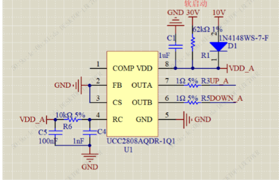

My design is open loop (OUTA and OUTB duty cycle is constant 50%), the starting current peak value is small (soft start time 1ms and above), the current soft start time can only be 400us, how can we improve the soft start time?
Can you help me see the schematic diagram?
The cs pin is connected to the resistor, which will cause the power supply efficiency to decrease and some troubles later. Does the CS pin need no resistance?
thank you!
  • Hi Eagle,
    You could add an external soft start circuit to the FB pin which gradually pulls the FB to ground to drive the COMP pin high. Select the R and C value to give you the desired SS time.
    PeterUCC2808A SS.docx

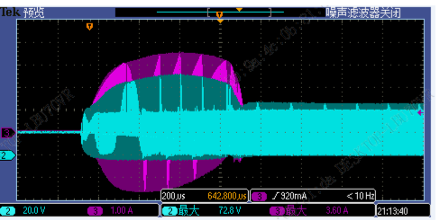

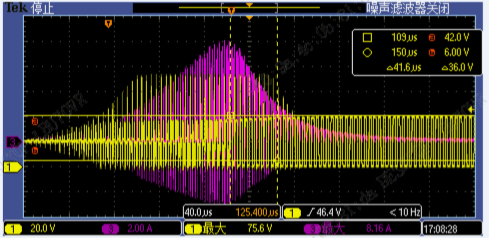

  • thank you very much! I found that current start and soft start time have nothing to do. My application is cs directly grounded, no current sampling, the waveform is as follows  a: the starting current and the peak value are large; the CS connection resistance refers to the datesheet   b starting current and the peak value is small; cs can be directly grounded?
    a: the starting current and the peak value are large                                                                               b starting current and the peak value is small
  • Hi Eagle
    During start-up the power stage must charge up the capacitors on the output of the power stage as well as deliver current to the load. I suggest you capture the output voltage and the primary current at the same time. I suspect that the current reduces once the output voltage comes into regulation.
    Peter

    What is the maximum voltage allowable for UCC2808A COMP PIN? Thank you!
  • Hi Eagle,
    COMP is an output and if the FB is pulled to ground the COMP voltage will go to the voltage level of the internal bias rail, something like 5V to 6V approximately.
    There is no need to force COMP high is the circuit are around the internal error amplifier is set up correctly.
