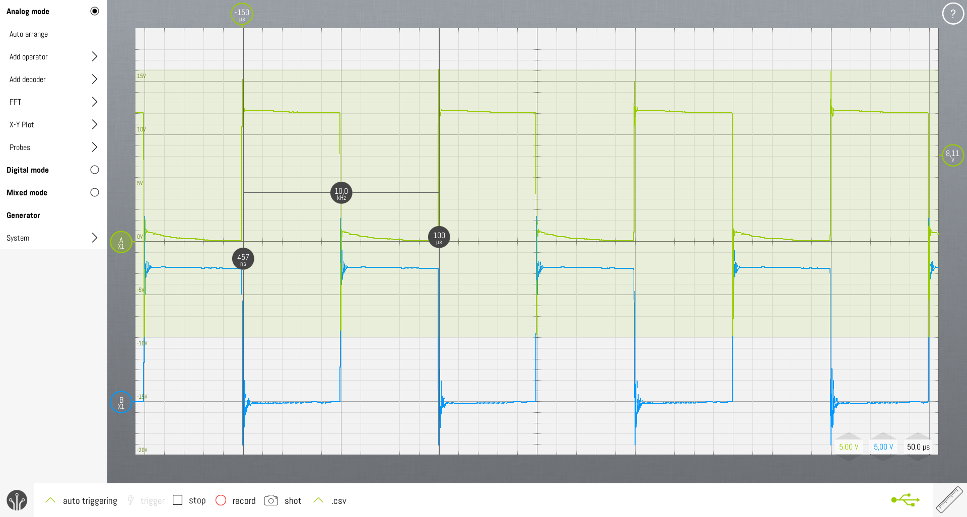

For a project I am experimenting with the UCC27211 high and low side mosfet driver. I want to make a "power" amplifier using the stated driver in combination with a n channel trench mosfet (SQP90142E). But it seems that I can't get the driver working properly. As a reference I used the "UCC27211 transient analysis" that is available for Tina-TI (see picture below). I adjusted the capacitor load (CloadHO & CloadLO) with a rough estimation of the N channel mosfet I intend to going to use. After building the circuit I measured with a scope the HO and LO outputs. The graph is in my opinion correct (minus the huge transients on the flanks, but that is probably due to that I use a bread board (A)).
Only when I connect the N channel mosfets gates to the LO and HO output (without connecting to mosfet any further) the HO output goes to 0 and will not recover anymore even when it is not connected anymore. And when I try to build the circuit stated in the datasheet, using the circuit with only one UCC27211. The mosfets will conduct straight away doesnt matter what timing the HI and/or LI has.
Does someone already experienced this or knows a solution, I will be very glad to hear it.

    Thank you for the interest in the UCC27211 driver. To be able to provide the best advice I would need to review a schematic of the driver, MOSFETs, and the load connected to the power train. One common issue we see with users of the high side driver in HB drivers, is the floating HB bias and the sequence required to charge the HB-HS capacitor, and maintain this capacitor charge.
    The HB and HO is referenced to the HS switch node. The HB-HS capacitor is charged typically when the LO turns on which forces the HS switch node near ground. At that time the HB capacitor is charged from VDD thru the bootstrap diode to HB.
    Can you confirm the HO, HB and HS waveforms in the condition you describe?
    If you still have concerns, provide a schematic and scope plots of the HI, HO, HB and HS waveforms so I can comment.

  • I had some time to improve the design of the circuit. Instead on a breadboard it is now assembled on a perfboard, trying to follow the rules in the datasheet. It looks like that made an significant improvement because it appears to work at a frequency of 500kHz. It will only get hot really quickly when I try to get it working on 800kHz (driver drawing ~100mA). if I am still working on it, i will make a different question for this (if i cannot be helped with the excising posts that are available with UC27211 getting hot).
