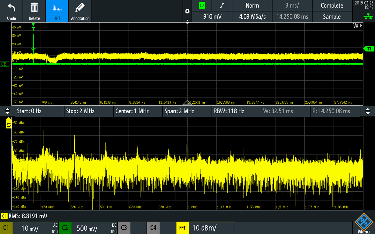

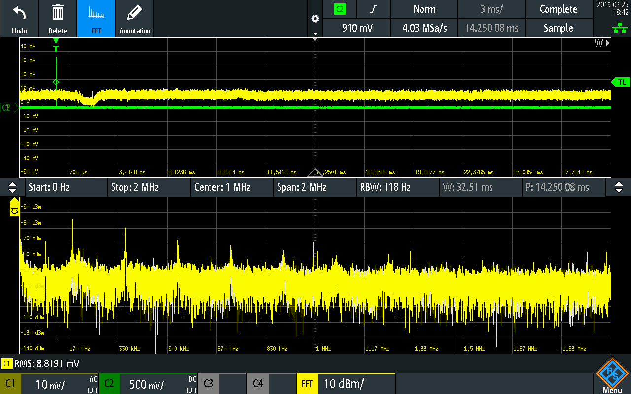

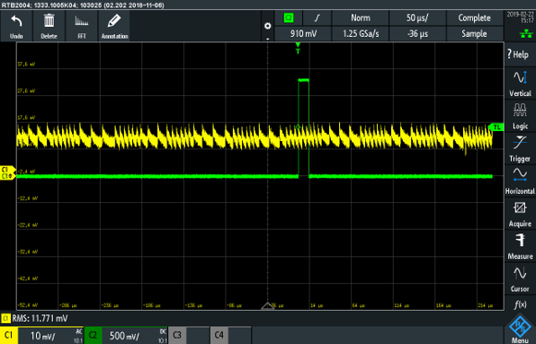

  • Hi Chris,
    We have now concluded that our ripple requirement is 1mV. I understand that that is not possible with a buck regulator, but still, if there is a way to get down to 5mV, then that would still be very helpful. Maximum current consumption will be 100mA.
    Below are three pictures of the waveforms showing the ripple. The oscilloscope is AC coupled during the measurement.
    Below is a waveform of the ripple with 50us resolution on the time axis:
    Here is a zoom of the ripple with ~83kHz frequency. 2us resolution on the time axis.
    And here is a zoom of the ripple with ~217kHz frequency 1us resolution on the time axis.
    Below is the FFT of the ripple:
    Josefin
  • Hi Josefin,
    Thanks for posting your ripple requirement. It is nearly impossible to get below 1 mV ripple while maintaining low Iq (operating in PFM).
    So, we made this reference design last year to show how to achieve this: www.ti.com/.../TIDA-01566
    By using a low Iq DC/DC followed by a low Iq LDO, you can have both low Iq and low noise.
    You could replace the TPS62801 in the above design with the lower Iq TPS62743.
