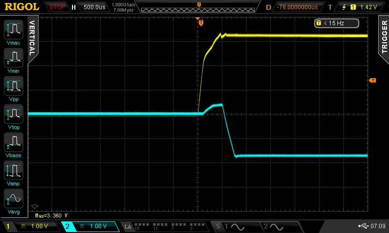

I have an LM27761 being used to generate -1.7V. It's enabled by a +3.3V signal.
When enabled I'm seeing the output rise to 380 mV within the span of about 400 us
before going low.
Is this normal?

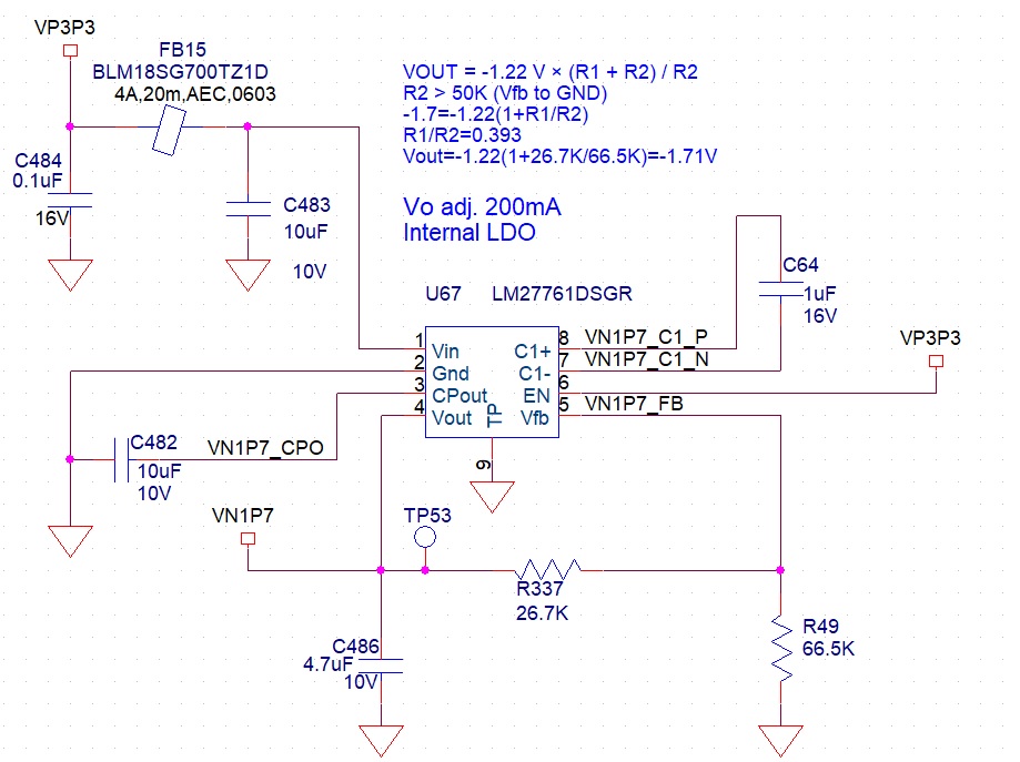

  • hello Dorian,
    Thank you for the quick reply. The only load is VS- input to two LMH5401IRMST.
    Here is the regulator schematic:

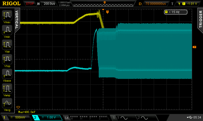

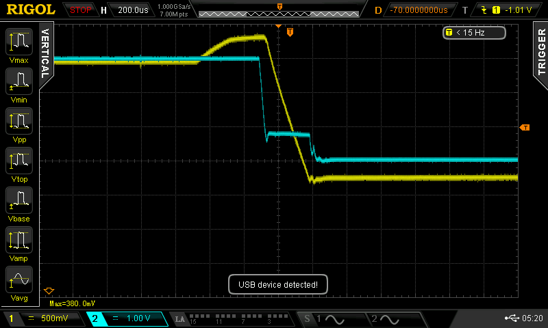

    If I probe the Vout and C1+ pins I see the following:
    Here is the input +3.3V and output -1.7V
    And here is the -1.7V output and CPOUT
    To me it looks like the +3.3V is leaking into the LDO output before the C1 capacitor begins
    switching. What do you think?
    regards,
    Tom
  • Hi Tom,
    According to the datasheet the EN pin brings the device into enable mode when it sees at its input a voltage greater than 1.2V.
    As you can see on your second scope shot, the system start operating as expected when your VIN is stable. I would recommend you to start controlling the EN pin when VIN is already stable.
    Does this make sense to you?
    Thank you very much!
    Dorian
  • hello Dorian,
    Thanks again for the quick support.
    So I'm still wondering why the -1.7 Volt output initially goes positive.
    Here is the schematic showing one of the amplifier loads. Since
    +3.3V comes up before -1.7V could the amplifier be somehow driving
    the -1.7V positive?
    regards,
    Tom
  • Hi Tom,
    Looking at your schematic, as your amplifier is also supplied by this 3.3V/N1.7V power line. I would assume there is current flowing from 3.3V and N1.7V (which is 0V at t=0s). This current would then flow in the LDO, and would cause that output rise. After that your system enters normal mode the LDO can compensate for it.
    If you can start your system without load you would be able to see normal operation. Is this rise a major concern in your system?
    Thank you!
    Dorian
