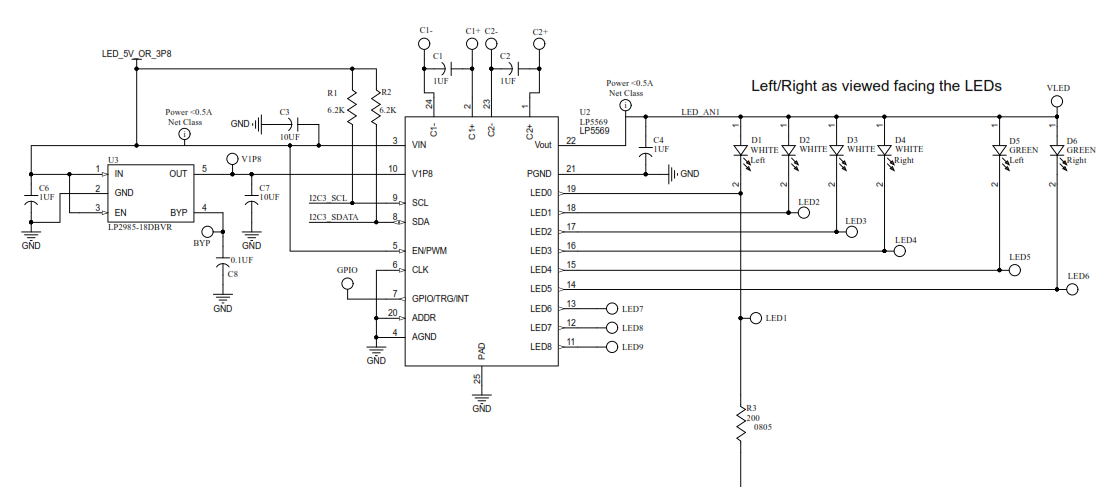

LP5569: I can do I2C transactions but cannot get any LEDs to turn on
Part Number: LP5569
I have this controller designed into my board and am attempting to verify functionality with an Aardvark I2C/SPI - USB device.  The transactions and responses look correct.  I can write the enable  register and see the output power turns on at 1x.  After that I can get no further response.  Setting 1.5x or auto dosen't seem to do anything.  Attempting to turn on any output results in no current being sunk.
I've tried with auto reg incrementing and without.
Here is a sample instruction sequence:

Any ideas what I am missing here?
