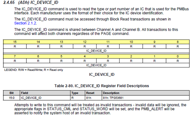

Hi Team,
I have a customer using the TPS53681 and they are interested to understand the last 8-bits in the 16-bit registers that are only documented to have 8-bits and what is expected.
The main question is on the IC_DEVICE_ID register, which is 81h in the datasheet, but outputs 8101h.
In looking at other 8-bit documented registers - register 98, the output is 3305h and register 5C is C0F4h.
Appreciate the insight! Thank you!
