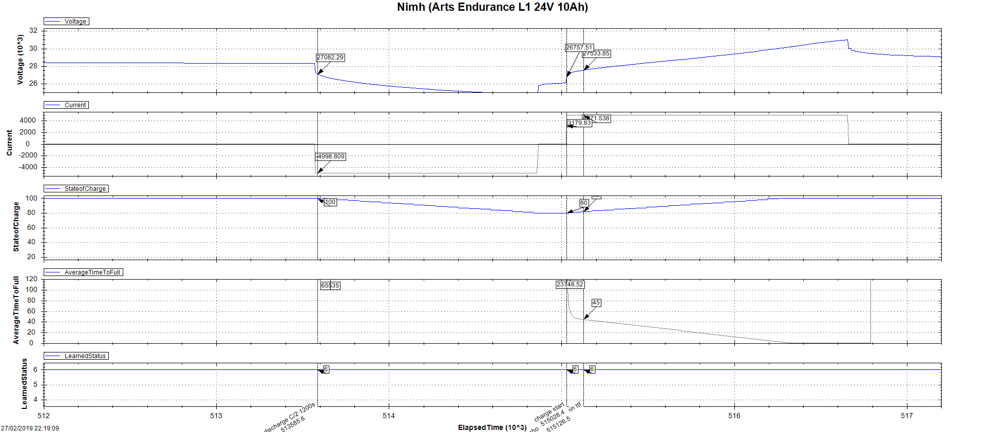

I'm starting to use a bq34z100-g1 with a Nimh pack (Arts Energy Endurance L1 24V 10Ah).
Chem ID : 6113
My learning cycle seems ok (status = 6), but the gauge cannot estimate accurately the time to full.

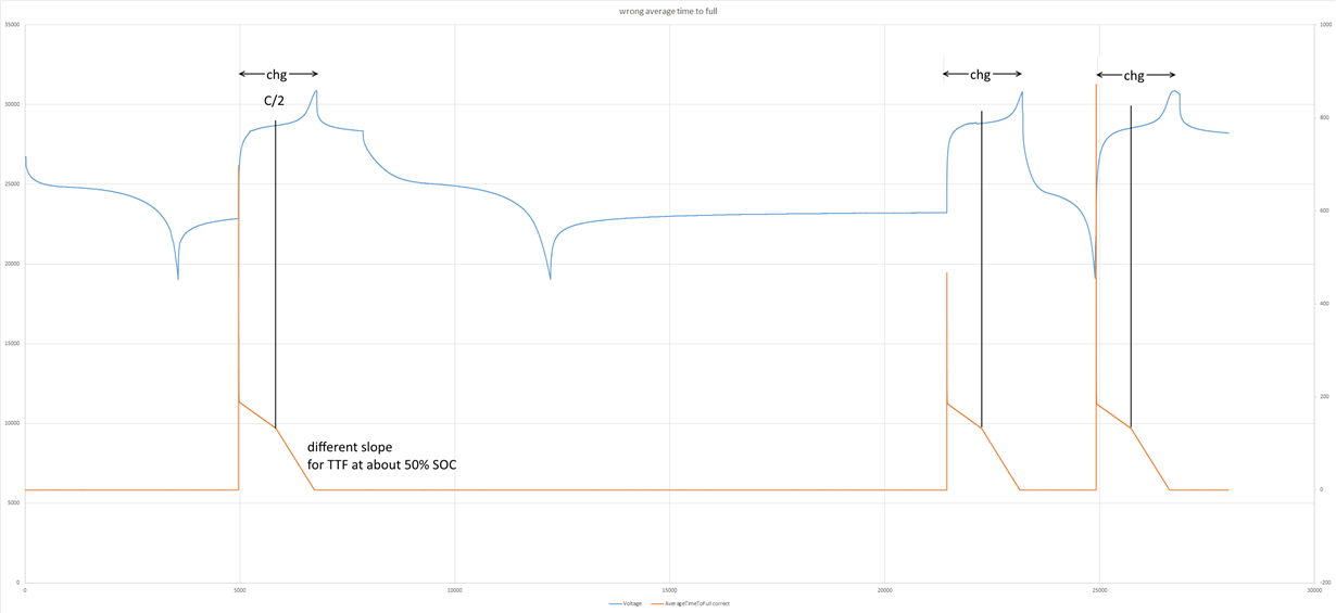

Here are some charging cycles @ C/2 (constant current 5A) which should set the time to full to 2h (120min) at the start of the charging cycle. The gauge estimates 180min (~50% off). During the charging cycle, the ttf estimation changes abruptly (cf. graph)
 1234.lc_arts_nimh_24V_10Ah.zip376data_memory.gg.csv.zip
Maybe some parameter is wrong in my configuration? Please, tell me how to correct that.
(I attached the log file and the last auto exported .gg.csv for completeness)
