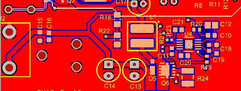

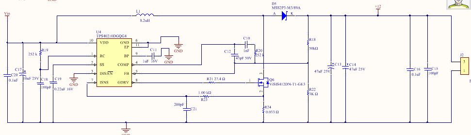

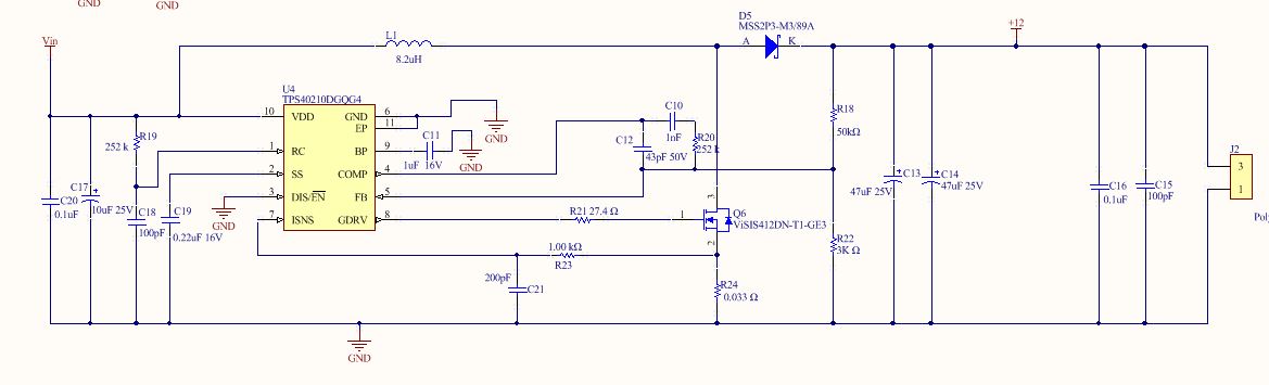

TPS40210: Boost Converter Not taking Load current
Part Number: TPS40210

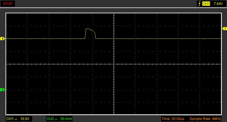

I am working with a boost converter design which should convert 6V-11.3V  input 12V stable output. i have used design formulas  shared by TI while designing and also cross verified with TI web bench.switching freq is set around 600khz. i am getting the output voltage 12V as per design when  no load is connected. As soon as i connect the load output Voltage is following the input voltage. switching is happening with load as well.
Inductor value 8.2uH, sense resistor 30mohm.
