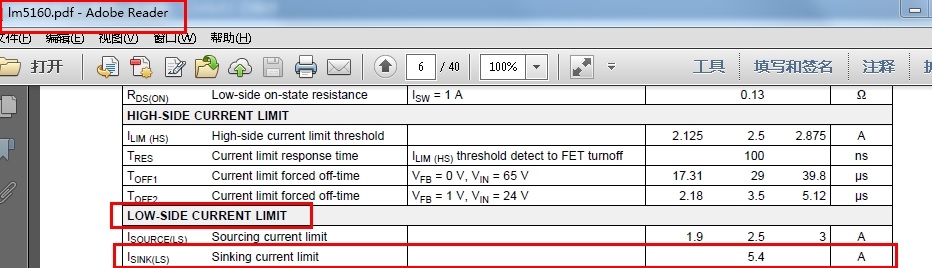

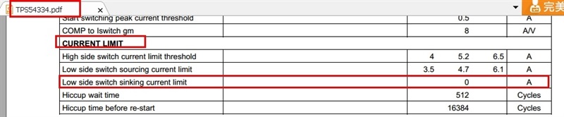

My customer is using our TPS54334 in their new project. They were trying to use TPS54334 with fly-buck topology but met issue and here comes some questions:

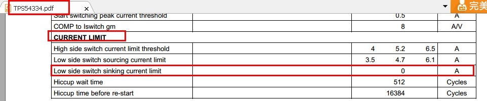

1. Are TPS54334 be able to work with fly-buck topology? If not, why?
2. When we checking the low side sinking current, it seems for TPS54335 the low side switch sinking current limit is 0A, Can I know why?

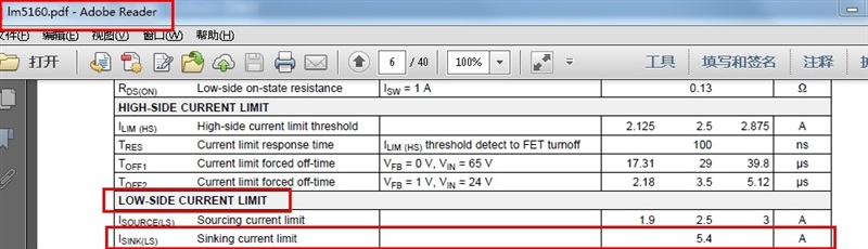

BTW, we also checked TPS5160, the specific is 5.4A, totally different with TPS54335:
So was this the issue that TPS54335 is not suitable for a fly-buck? Pls correct me, if not.
