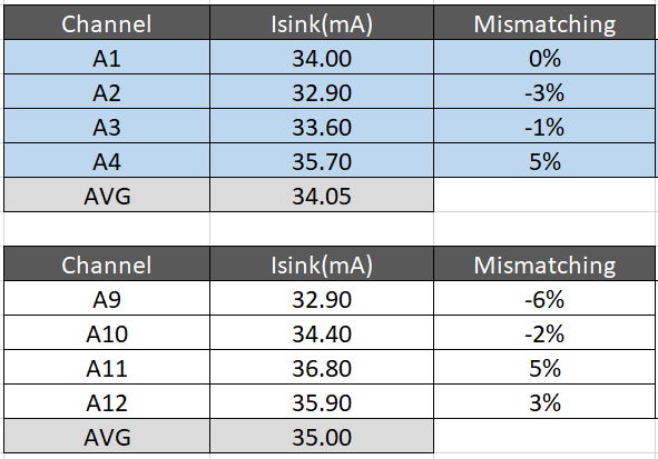

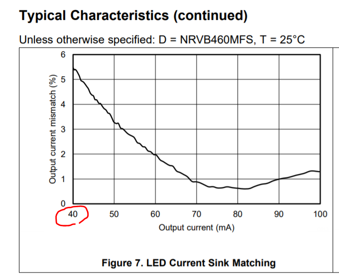

Customer wonder if output current can support lower than 40mA, what's the accuracy? we can't see that from datasheet.
Any other side effect for lower current application? (They might use 30mA~35mA/per channel)
Thanks.
