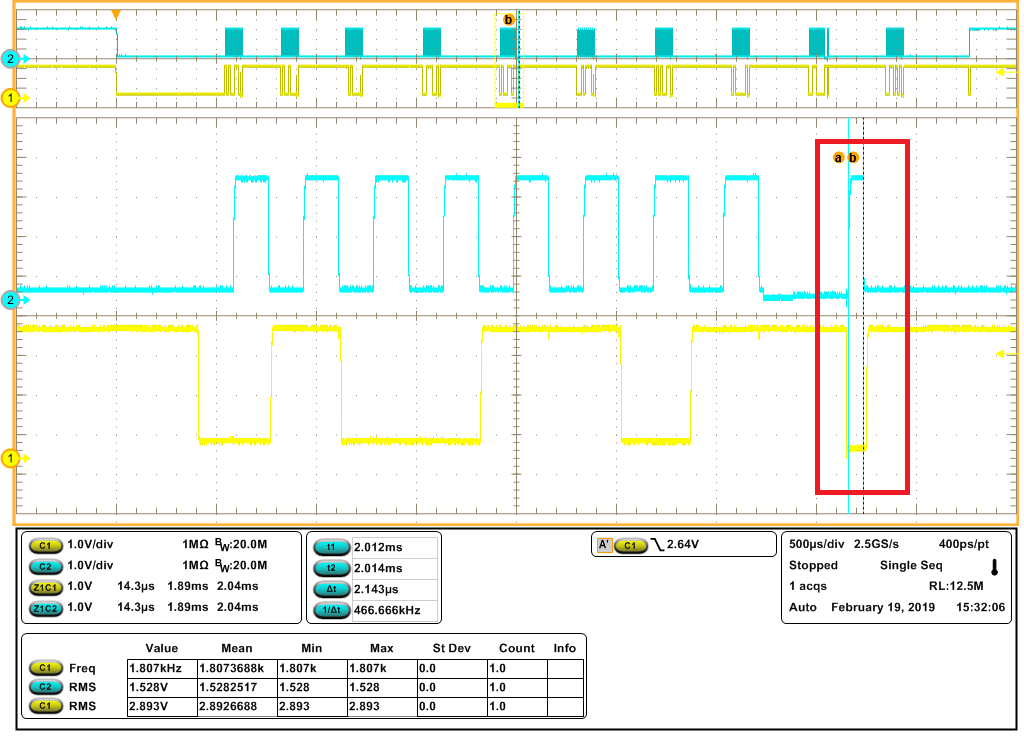

Hi TI experts,
I  used UCD3138OL64EVM to test PMBus write command with 100khz trans speed to  microchip pickit serial analyzer,but I found that ACK's clock is not matched that I set 100khz trans speed,
please see the waveform as below ,
ex: Write data [B6h][48h][D0h][39h][4Dh][2Eh][53h][41h][30h][35h] , did I miss something ? thanks.
  • First of all, what is the configuration? Is the UCD3138064 the master? If so, what is the slave? It looks like the slave, whatever it is, is stretching the clock before the ACK? It would be useful if you could put a small resistor in between the master and slave, equal to say 10% of the pull up, so that we can see which is pulling the lines down. Actually, it looks like the slave is pulling down before the ACK, because the clock there is going lower than at the other points.
    Does this clock stretch/short ACK happen for every byte, or just with every 4th byte, or what? Perhaps the clock stretch and the short ACK are related.
    Can you please share the code you are using for the write, so that we can verify the issue and see if there are any changes we will suggest to the code?
    Please include all initialization of the interface.
    also, can you tell me which interface you are using, the I2C, or the PMBus?
  • Han Lee, have you resolved this issue on your own? I'm willing to work on this with you, but there are many options in how you could program this, and I want to start with exactly what you are doing, not just try various programs to see if I can duplicate it.
  • Hi Ian,
    Thank you for supporting us ,I'm still debugging with customer now , attach information,
    Device : UCD3138064 64 Pin
    Master/Slave : slave
    This condition only happened at every 4 byte(Not including address)

  • If the UCD is the slave, the issue is with whatever the master is. The UCD will only pull the clock low before the ACK, unless you are doing something with the raw PMBUS lines, which I don't think you are. Further, note that before the ACK clock rise, the clock line goes lower that it has been. That tells me that there is a little resistor between the master and the slave, and your scope probe is on the UCD side. the after the ACK, the clock is pulled down, but just as far as the clock is between the normal bits. This tells me that the clock is being pulled down by the master again.
    The reason this happens every 4 bytes is that is when the 4 byte RXBUF fills up on the UCD. The hardware stretches the clock until the software reads the RXBUF. So the master you are using is putting out a short ACK clock if there is clock stretching. At least that's the way it looks to me.
