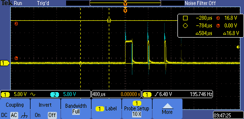

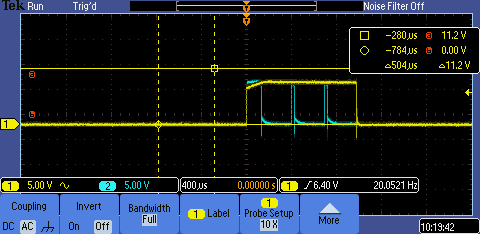

I have some problems here: First of the problem is that I still have the issue of "shutdown mode". The output pulse have the same behaviour that before. Making some test, output is delayed, no matter the diode is on the circuit or not. in the grafic below, you can see yellow line (pulse) and blue line (output pulse), and see how the output it is delayed. As I said, no matter is the diode or not
Secondly and probably more important. From the voltage of the output and the led datasheet, I would say that output pulse is far from being 5 A, and it Will be closer to 2.5 A. I dont know exactly why, maybe I am requiring too much to the external source or something is wrong in the values of the circuit.

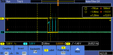

Anyway, I want to recalculate everything to get 2 A and 9 V, because 5  is too much for my application. When I made calculation, I choose 0.1 ohm in Rsns and 5k6 in Roff to have about 9 V and 2A. i think this is more or less correct. Doing that, I have the following output pulse (it is the yellow line)
In theory my clculations are good, so I dont know what is happen. I have making some test, changing the Rsns of the circuit, step by step, to see the behaviour of the theoretical current against the real current and when I goes up  over 0.06 ohm, the behaviour is as the behaviour above.. Below 0.06, is as the first graph.

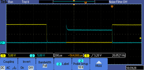

    Thanks a lot. One of your tips gives me a solution for one of the issues. Changing the capacitor of Vcc from 1 us to 4.7 us  (Cf1 in my design) solve the initial delay that I had with the PCB without changes ( Rsns 0.05). I have make some test, and it works with or without  UVLO-PWM diode. Here is the oscilloscope graph. The initial delay has totally disappear.
    BUT I still need to increase Rsns to decrease the current at the output. So my next step has been again increase Rsns. Just using 0.068 ohms, I have again an interrupted pulse, as follows
    I dont know if this effect its the same tan before. If I understoood correctly this is because, as I have decrease the current, the output voltaje has also decreased. Is that correct? I dont know how can I change that, just with the design I have. I dont want to add a resistor and a diode between output and Coff, unless necessary because I have some PCBs already done. But anyway if it is the only option I Will try.

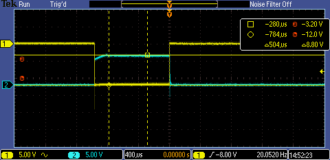

    When there is a pulse, i have 8.80volts at the output (first graph). When the output pulse is interrupted, I have less, about 8 volts.

  • Sorry I did a mistake, No, the graphs are after the inductor. I put them here again:
    Rsns 0.05, Roff 5k6, Cf=4.7uF. Blue line before inductor, yellow line after inductor
    Rsns 0.05, Roff 5k6, Cf=4.7uF. Blue line before inductor, yellow line after inductor, the first pulse of the train of pulses is about 90us, with 267 us until second pulse. this second pulse is 30 us
    And here are joined Vout for Rsns 0.05 (yellow) and Rsns 0.06(blue).

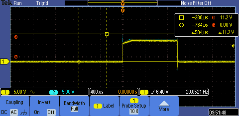

    I have measure Vcoff, and honestly I am not able to see more than a small peak, about 800 mV-1 V in both cases (even with Rsns =0.05, where I have correct output), and with a very noisy signal. Don't know why. Its what I have (very strange):
    I have try to add a diode and a 10k resistor between Vin and Coff. this is the result. Honestly, dont know what is happen. Blue line output, yellow line Vcoff. 1.60V in the peaks, over the trheshold. But I dont know why this shape and Why is still not working

    Here you have: Rsns 0.05 . Blue line Vin at CSP point (Rsns+Cin node). Yellow line the output (about 8.8). Vin is 12 V except a small drop when MOSFET is conducting
    Then we have change Rsns by 0.06. Blue line Vin at CSP point (Rsns+Cin node). Yellow line the output (interrupted pulse). Vin is 12 V , obviousy there is no drop as there are not real conduction
  • Hello Ramiro,
    Okay, think I figured this out. Your P-channel MOSFET RDSon is way too high. At 5A there will be at least 2.5V drop across it. This also will cause it to blow up if run at high duty cycles since it will be dissipation over 12 watts. This explains why the input and output side of the inductor are the same voltage on your previous oscilloscope pictures.
