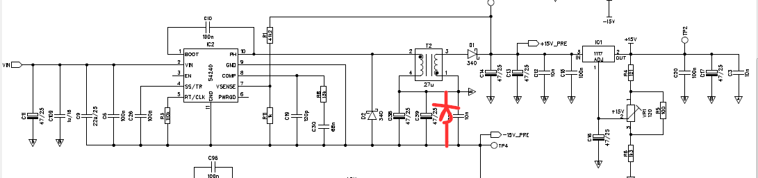

hi  Team:
VIN:9V,  Vout:=15v/-15V,100mA
1. TPS54240 About 5 percent of the damage occurred when the power was turned on(Test no load or with load  all have damaged);
2. Use a multimeter to test: there is no difference between damaged IC pins and normal IC;
3. The damaged IC  cannot start working.

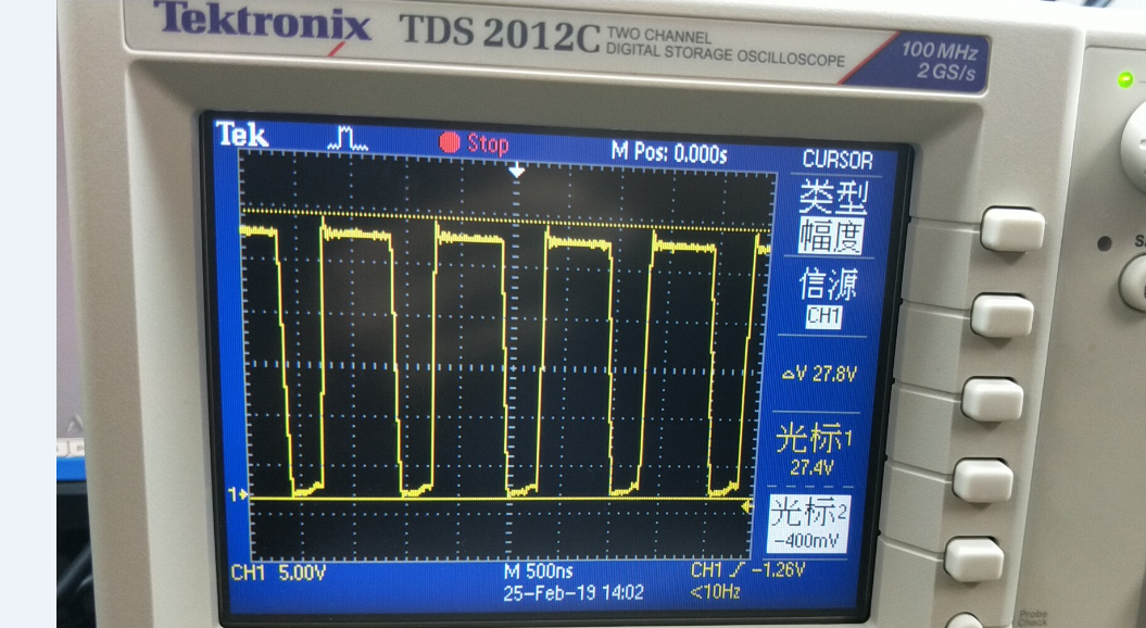

Measuring with oscilloscope:VPP(pin10-pin9)=27.8V;
How to solve this problem??
