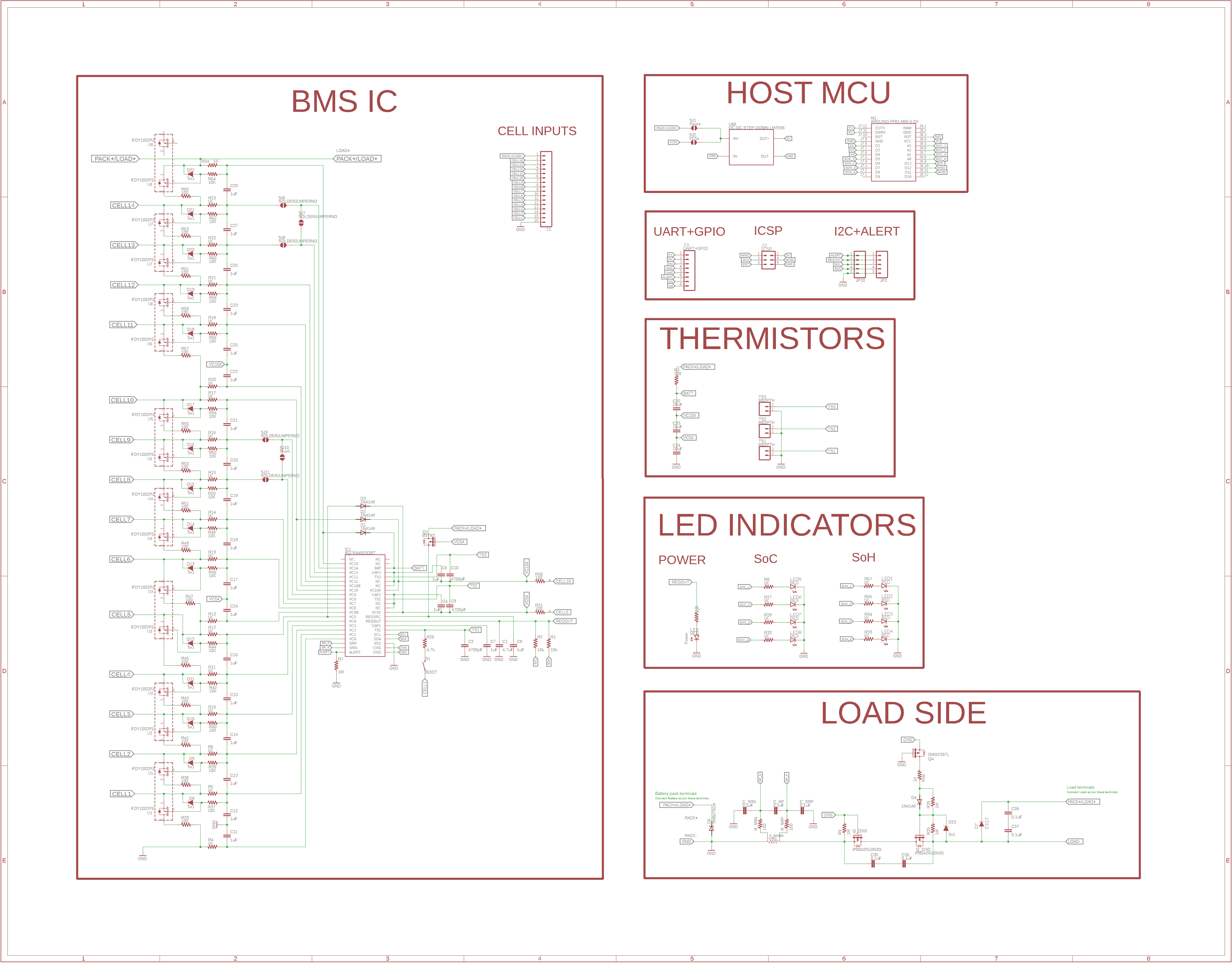

Hi experts,
I have made a 13s-15s BMS using BQ76940 (3.3v version). I’m fetching the cell voltage data from the BQ using atmega328p. The ckt has jumper pads which can be used to configure the board for 13s-15s battery configurations.
Kindly check the schematic
There are 6 jumpers pads in total – SJ6, 7, 8 and SJ10, 11,12
SJ7 shorts VC13-VC14
SJ10 shorts VC8-VC9
So the jumper states corresponding to 13-15s config are
13s: SJ6 open, SJ7 close, SJ8 open
        SJ10 open, SJ11 close, SJ12 open
14s: SJ6 close, SJ7 open, SJ8 close
15s: SJ6 close, SJ7 open, SJ8 close
        SJ10 close, SJ11 open, SJ12 close

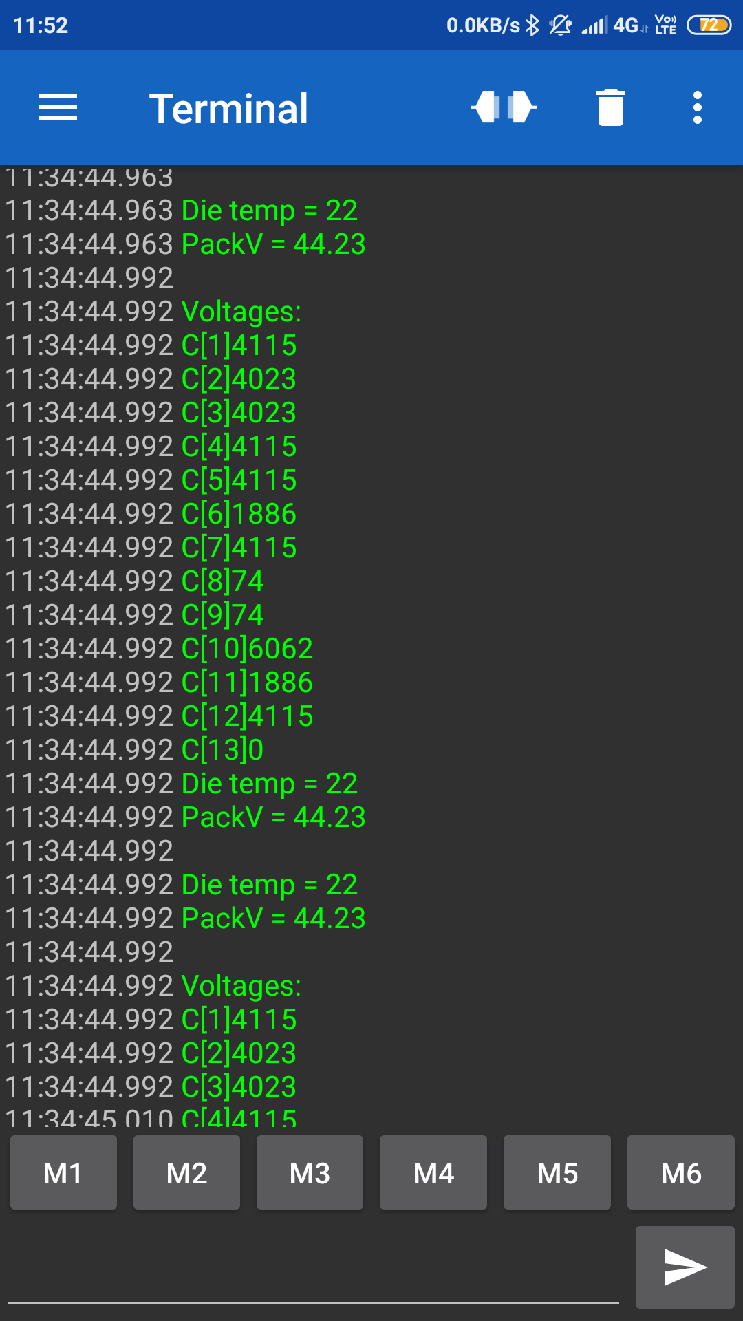

I’m using the board in 13s configuration. I’m using Bluetooth for debugging, pushing the data on a Bluetooth terminal on my phone I get the following output. Kindly check the output image(black background with green text)
C1-5 are reported perfectly
C7 is reported perfectly
C12 is reported perfectly
Rest all cells’ voltages are incorrect. In my ckt, VC0 is connected to gnd, VC15 is connected to BAT+. So the cell connections are
C1: gnd-VC1
C2:. VC1-VC2
C3: VC2-VC3
C4: VC3-VC4
C5: VC4-VC5
C6: VC5-VC6
C7: VC6-VC7
C8: VC7-VC8
C9: VC9-VC10
C10: VC10-VC11
C11: VC11-VC12
C12: VC12-VC13
C13: VC14-VC15
I checked the datasheet and the sample ckt shows VC0 is grounded. However in TIDR773, TIDR00792,
VC0 isn’t grounded directly. Is this what is causing improper cell voltage issues?
 What is the cause of the improper cell voltage readings? If my connection is wrong, what is the correct connection?
  • Hi Pranit,
    The VC0 connection you have is correct. The datasheet method is the right way.
    There are a few issues in the schematic:
    - The BAT pin needs to be connected to the top-most voltage through a filter resistor. I don't see this connection in your schematic.
    - The power filter resistors (R30, R31) are too small. 1k is recommended.
    - D23 should be a higher voltage value (15-18V)
    - A blocking diode is needed in the REGSRC circuit. See Section 9 (page 14) of this app note for a full explanation: www.ti.com/.../slua749a.pdf
    - The jumper states you described appear to have problems. For example, both SJ6 and SJ8 should not be open since this would result in no connection to the battery cell. One of these should be closed. And then a short is needed across the cell connectors as well, otherwise the cell balancing circuit will try to adjust the cell voltages. I think you also wanted SJ10 closed.
    I hope this helps.
    Matt
  • Thanks Matt!
    Yes you pointed it out right that jumper states are incorrect. I'll be shorting all the jumpers and by doing so VC13-14 and VC8-9 will get shorted and also the neighbouring cells will get connected to the IC.
    I wont remove the balance circuitry for the undesired cells, rather I'll not connect the undesired cell. So in short, VC13-14, VC8-9 will be shorted and no cells will be connected across those two pairs of terminals. However, the balance circuitry related to those two cells will still be kept on the ckt as it is.
    I will change the power Resistors R30, 31 to 1k
    And yes there is a filter resistor of 100ohm between BAT and Pack+/Load+ terminal. Its shown in the "THERMISTORS" section of the schematic.
    I'll also change their diodes as you mentioned and add the protection ckt for regsrc
