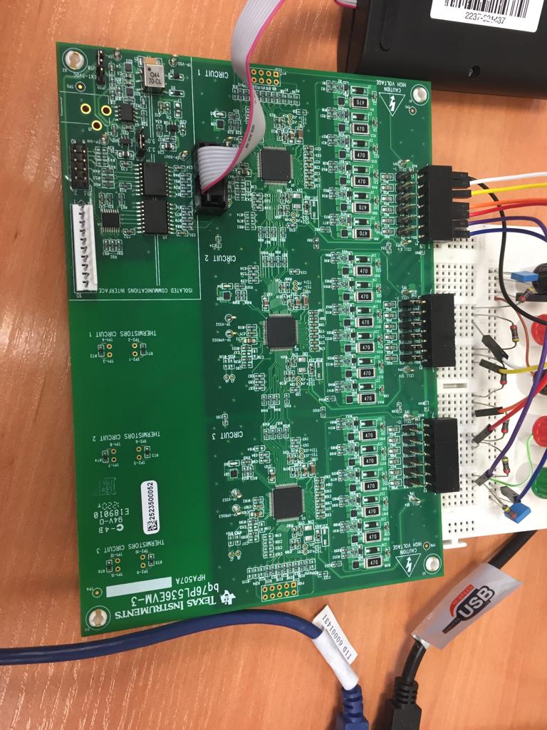

I am using for my "end of degree thesis" this device coneccting it to 6 LiPo battery cells in order to watch every cell voltage in my PC. Unluckily, and though I have installed the drivers which are needed and following step by step your queeck start guide, a warning appears when I try to connect it. This warning says: "there were no devices found".
I have already checked out every connection and made sure the voltage reaches out the integrate circuit, so I have no idea what is going on.
Could anyone provide me some information about what I'm probably doing wrong?

    No problem, thanks for the clarification. Let's start with debugging the hardware to make sure your setup is correct before moving to the software.
    * Can you please confirm if any changes have been done to the EVM?
    * Please share a picture of your setup to see your connections as well as the jumper configuration you have on the board
    * Are you using battery cells or a power supply with a resistor ladder? For initial debugging, I recommend using a power supply
    * After power up, what is the voltage observed on BAT, LDOA, LDOD1, LDOD2, REG50 (5V) pins, and what is the current on BAT?

    Of course I did, they were succesfully installed. The problem comes when I try to communicate my module with my computer.
    This EVM module has two USB connection points. One for an isolated connection and the other one without any isolation. I have checked both USB connectors and the same problem comes out.
    Every pin has the required voltage but my suspect is about the SPI communication, maybe some signals are not entering the IC. What advice or recomendation could you give me?

    I can confirm any changes were done on the EVM.
    As you say I am using a power supply connected to some resistors.
    After power up, the voltage you have asked me are:
    BAT 18V (voltage I am using as supply)
    LDOA almost 3V
    LDO1 and LDO2 have no voltage
    REG50 5V
    Another question I would like to ask is, what is the LED called D3, D4 and D5 for? In the schematic sheet I can see where they are ubicated but I do not know their job.
    I am including a picture of my EVM and its connections.
  • Hi User,
    LDOD1 and LDOD2 have to be 5V when you power on the device.
    Please double check the set-up.
    Please connect Aarvark to the P5. It works better there.

  • Roger,
    Sorry I didn't answered. Looks like the Evauation Module was already damaged when I started to use it. Thanks for your attention anyway.
